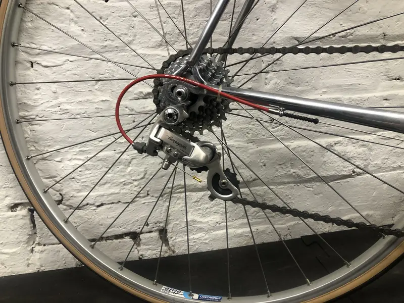

Popped a set of Campagnolo Xenon pedals on (after a full strip and deep clean of course)
This is just about as far as we can go till the correct indexed rear mech turns up… :facepalm: fingers crossed before the end of the month as it’s in RBotM and I would like to get the bar tape on! :roll:

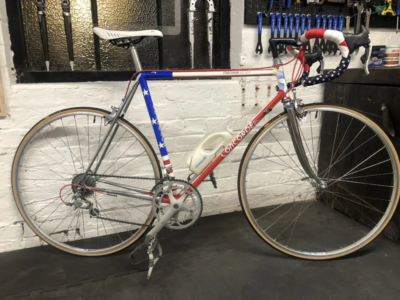

And it’s finished…… :D
Thanks to both AllenH & LGF, as the replacement 8 speed “Veloce” rear mech made a massive difference and combined with a replacement G-spring in the shifter all is as it should be… and just in time for RbotM…..
Jimmy has a PE lesson tomorrow afternoon, so that’s when the shake down ride will happen (if it’s not raining) and hopefully I’ll get some nice outdoor shots. 8)

Glad you got the shifting sorted, Jimmy's a lucky lad!
Those new style campag cables are impressive. I used them with Veloce 10 on my Raleigh and found they made the shifting perceptibly slicker over the original cables that came with the groupset.
That bar tape is perfect, I've never seen it before but it's spot on for the livery.
Looking really fabulous and agree about the bar tape, just sets it off really special.
I am sure it will ride beautifully.

Cheers Dawg, tape was a lucky find on e-bay… does look good doesn’t it?
Jamie
Cheers Jamie, ride report from the lad this afternoon (fingers crossed)

I think it’s very pretty apart from.............
The black stem. Silver would look so much lighter in all ways. And match the post.
