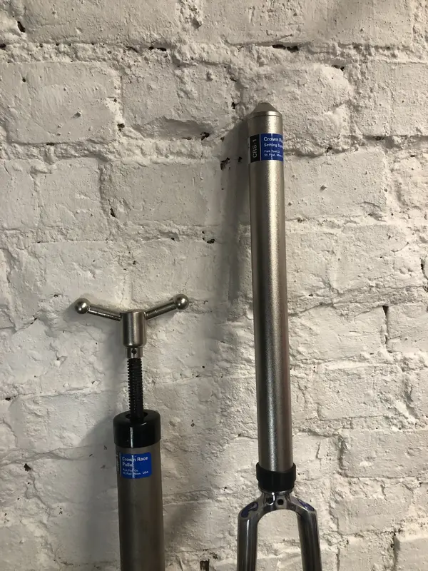

Bit of a lazy day today.. not much done. BB axle, sleeve and cups sorted then I had a dig for some other Campag bits I have stashed in my secret reserve…(put away for a specific build) so these will be on loan for the next few years. :wink:
A tidy mid 80’s Gran Sport headset gave me an excuse to use my Parktool Crown race puller and setting tools 8)

Having used basic tools most my life for most bike jobs i have found myself over recent years buying tools i never before needed, and being pleasantly suprised at how more effortless they made the job. So, im curious, how does the race puller work, and does it work well with stubborn races?
Re: Our Jimmy’s lock down build - Concorde Astore 89?
At the bottom it has two “jaws” that clamp under the crown then the threaded bar in the pipe pushes against the top of the steerer tube whilst the main body of the tool pulls the jaws up.. it works so well.
But... it super expensive, I only have one because a local one man bike shop decided to retire and sold some of his tools at really low prices.

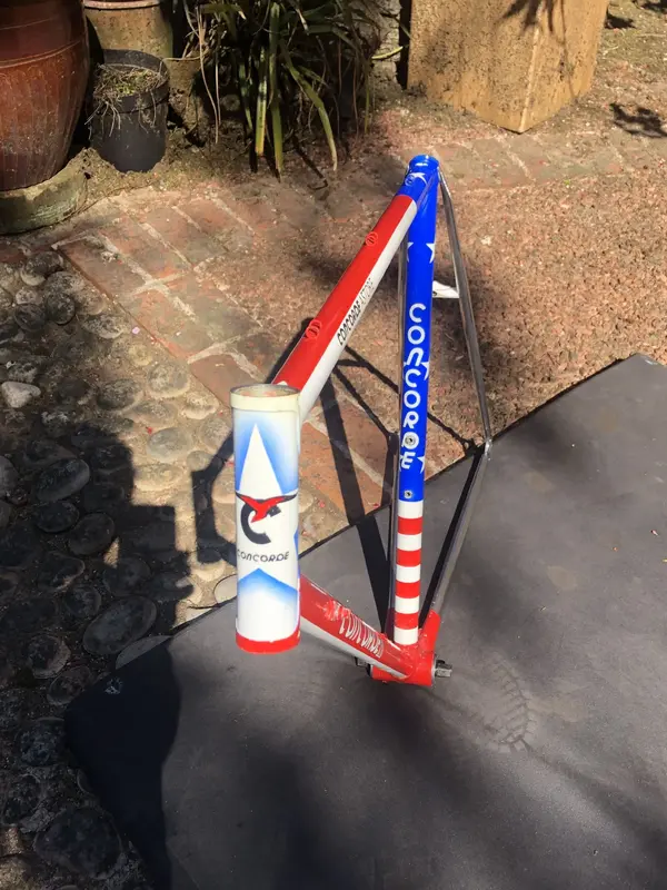

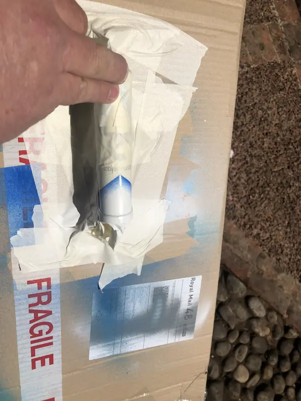

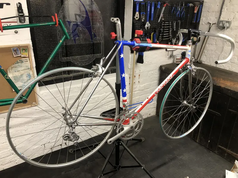

Although I said I wasn’t going to go all “Peachyfied” on this build, more of a clean-up and bolt-on, there is one area I can’t ignore, and that is the head tube… not sure what happened here, but it looks like someone took a pot shot with a twelve bore!
Perhaps aiming for THM but caught NeilM square in the face whilst they raced on that hill climb?
Anyway, it spent the night with an Evaporust poultice to convert the surface rust...
Then this afternoon the sun was shining and I had a beer so I thought, ‘I can’t make it any worse can I?’
So a fine layer of filler, a blast of white primer, a whiff of blue and a coat of clear….
You be the judge....

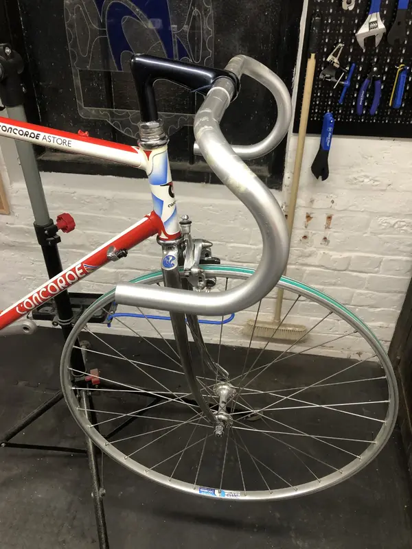

Anyway, this is as far as we can go whilst we wait for some parts.
Italian threaded Freewheel :facepalm: (and yes, I know this needs cleaning)
Brifters for this lovely Cinelli combo and some tyres.
(saddle clamps are being worked on) :wink:
