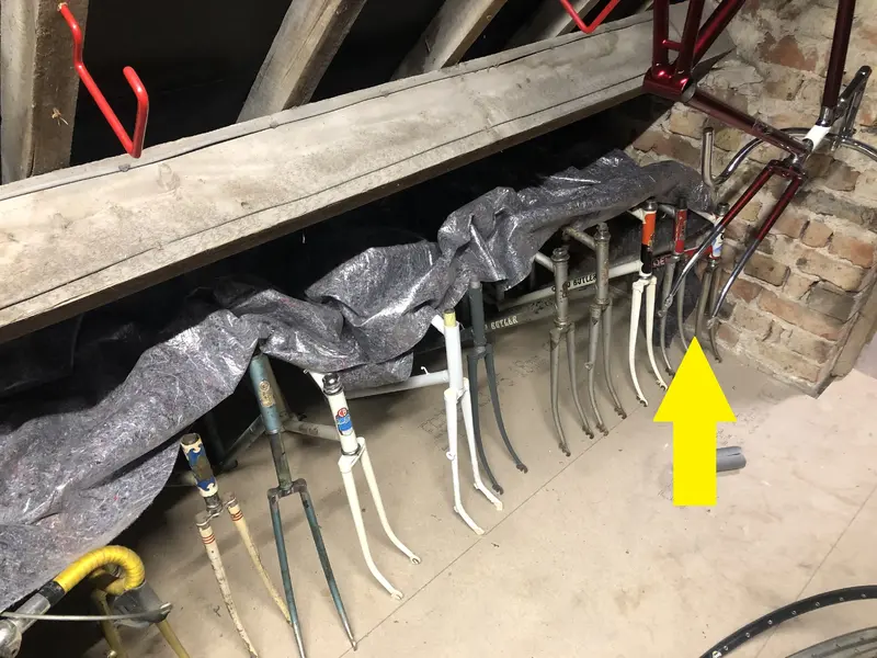

At 22” it was too big for the lad, so was safely stashed away along with the rest of the queue.

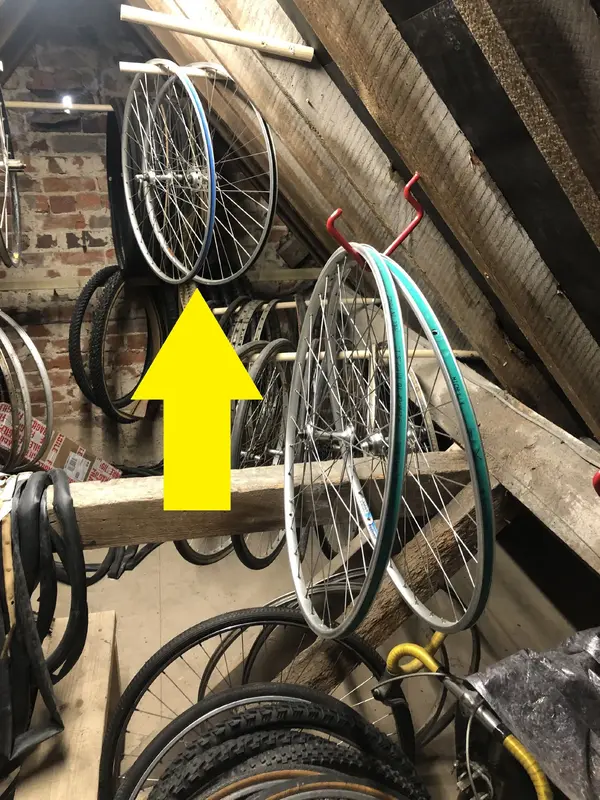

So I sent Jimmy up to the hayloft to go fetch it down, and told him to look for a 700 Wolber wheel set that were also hanging up there.

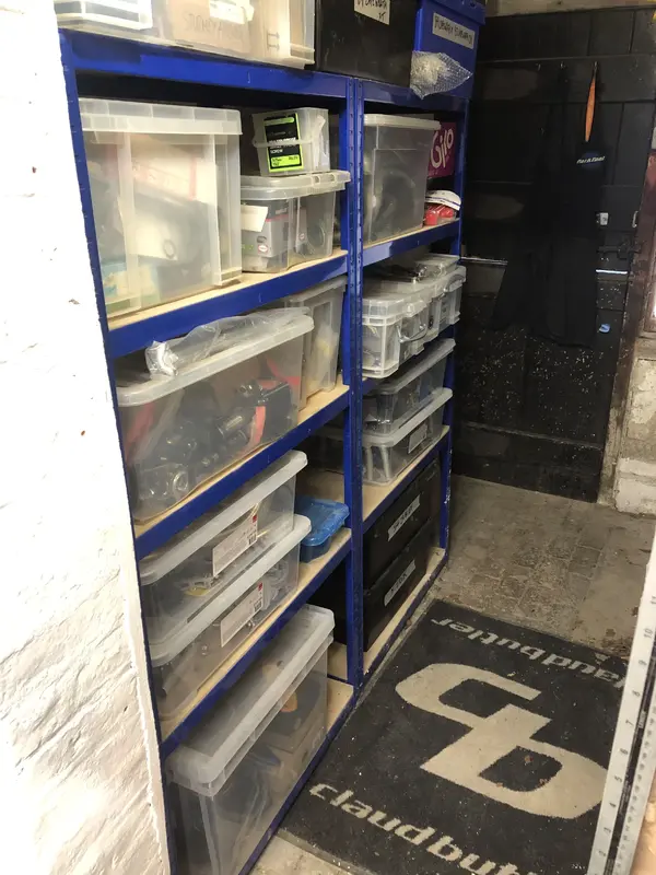

Then to get the box labelled ‘Shimano Road’ from the parts store and have a dig through the 105 & 600 kit whilst I take the dogs for a walk….

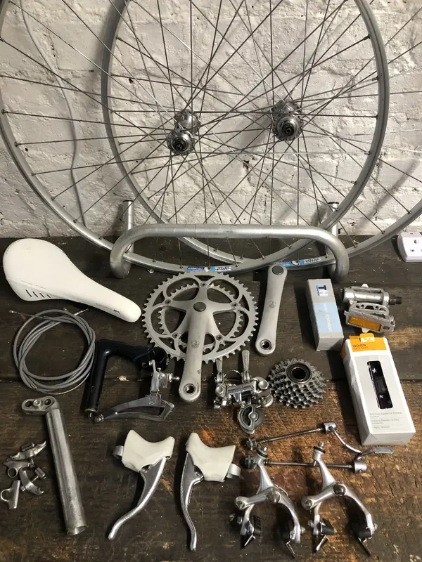

A set of Ambrosia rims on Campagnolo hubs, Cinelli bars and stem, and as much Campag kit as he could find! :shock: Cheeky sod…….

He’s now just informed me he doesn’t want to use friction down tube levers but rather indexed brake/shifters... and Campagnolo at that!
I’ve explained it would be easier to go down the 5.5mm spaced Shimano route as the hub on the Ambrosias is threaded for a freewheel..
I’m not sure anyone made a 5mm spaced freewheel compatible for early Campagnolo indexing?

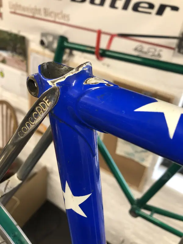

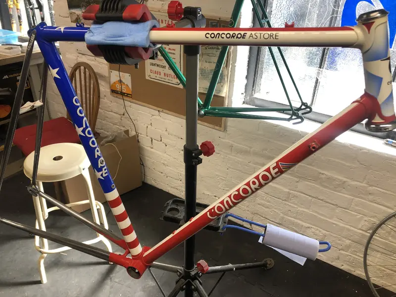

This afternoons job was a deep clean and T-cut, removal of all grease and old shop transfers (yes, I know these had a certain authentic charm, but they were looking more than a little dog eared now)
A quick polish up of the chrome, didn’t need much.
Then out with Jimmy’s Airfix/Humbrol enamels for some touching up..
