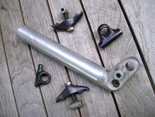

The SR Extra Super Light post up close >>
It looks quite a lot like a Nuovo Record post, but with a lot material shaved away and titanium hardware. The result is a is a post that weighs substantially less.

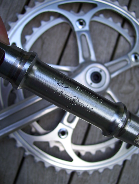

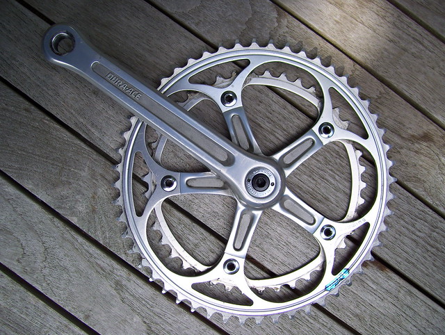

The Dura-Ace crank I will opt for >>
Also with the one key release bolts and 'W' cut rings. Fully period correct.
These cranks require a wider spindle >>
VeloBase mentions 195gr for the Extra Super Light post and 320gr for a Nuovo Record example.

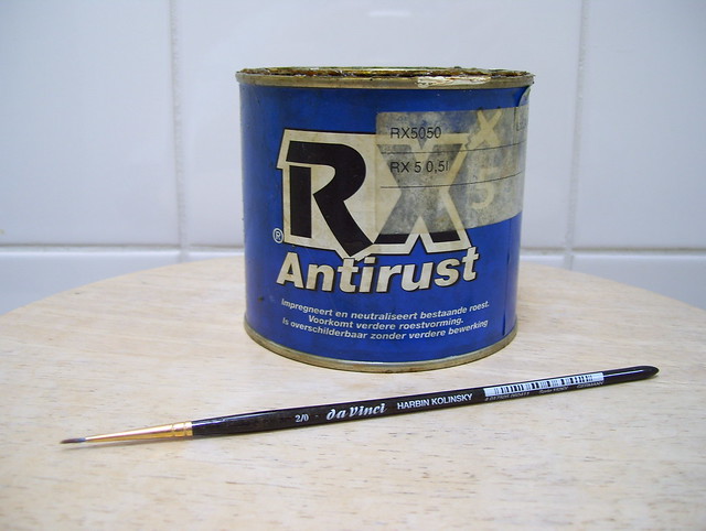

Little touch up work to do. French blue gloss from Modelmaster always has proven to be an excellent match with the early 80s professional Koga's. Gold for the panels.
I do have pencils 00, 0 and 1 available, but for this frame the smallest does (00).
First however >>
Base coat with rust prevention additives. 0.5 liter, so enough for a million frames.

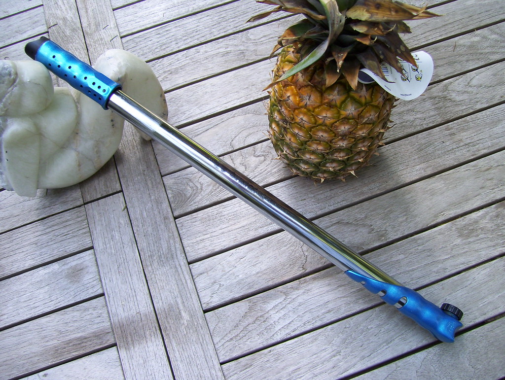

There were a couple marks where the bottom of the pump sat fitted. Top is smooth and left no traces fortunately. I am not a fan of frame mounted pumps. Normally they don't sit fitted with protection pads. Removing the pump is always the 1st thing I do when I collect a bike.
I must say the pump matches okay colourwise.
