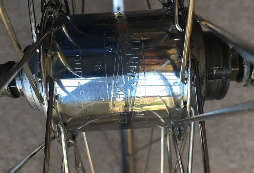

A few days back, I was worrying about which way to go with the wheels, I had always planned on using a Sturmey Archer 4 speed FW (Four Wide ratio) as something a little different but still useful on the rolling East Yorkshire Wolds. But my 1958 FW unit was away being serviced… So plan B was to set her up as a 1/8th single speed cog that I would swap out…..
PeachyPM":357nkezk said:
The History Man":357nkezk said:
Single speed? Really?
Not the original plan, it was going to have a 4 speed Sturmey FW hub, but that needs stripping down & re-building as its only got 2nd, 3rd & 4th engaging at the moment and I don’t have time to do that and build this bike, so that will come latter..

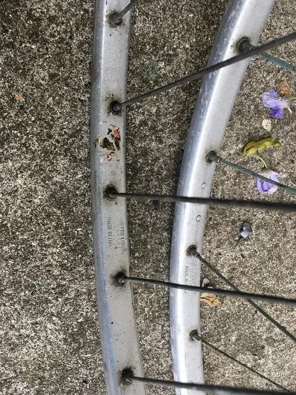

But, hurrah! The hub is back! So a quick change of double butted spokes and we are back in business, matched with a tidy small flanged 32h Constrictor front hub and a pair of once rough but now beautiful Fiamme rims; 40h rear & 32h front. Oh, and some stickers from H Lloyds of course!
These have been dropped off this morning at my LBS, should be ready for pick-up Saturday morning.
