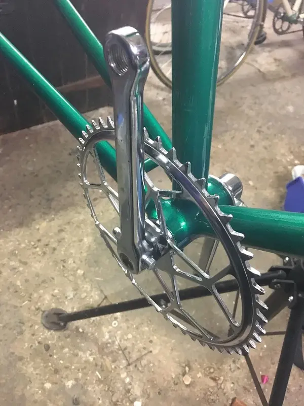

For the main crank/chain ring I’m using this massive 52t Williams crankset, with 1/8” wide teeth, cleaned up very well with the old foil trick showing off the Williams name.
I believe this pattern was used way into the 70’s but by then I think they’d changed to more common 3/32” and losssed the “Williams” stamp I guess to save one more process/money?

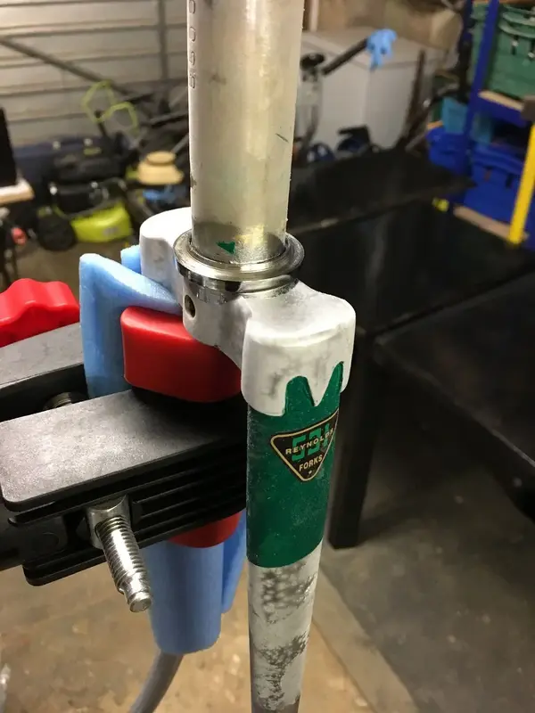

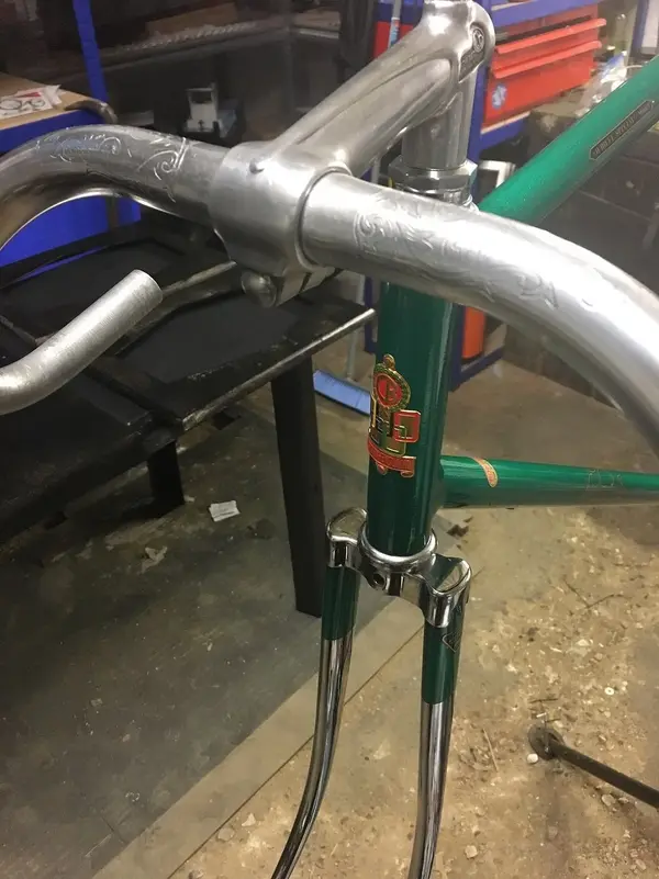

I was getting a little impatient with the stripping and cleaning, so I thought I put a few bits together, just so I can feel I’m achieving something!

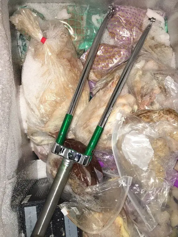

First job I decided to do was get the head together, so into the pig freezer went the forks for a couple of hours, and I hung the bottom bearing ring in front of my heat gun for about 10 minutes. This proved enough to shrink the forks and expand the ring so as to allow it to fall pretty much into place with the lightest of taps from a piece of softwood.

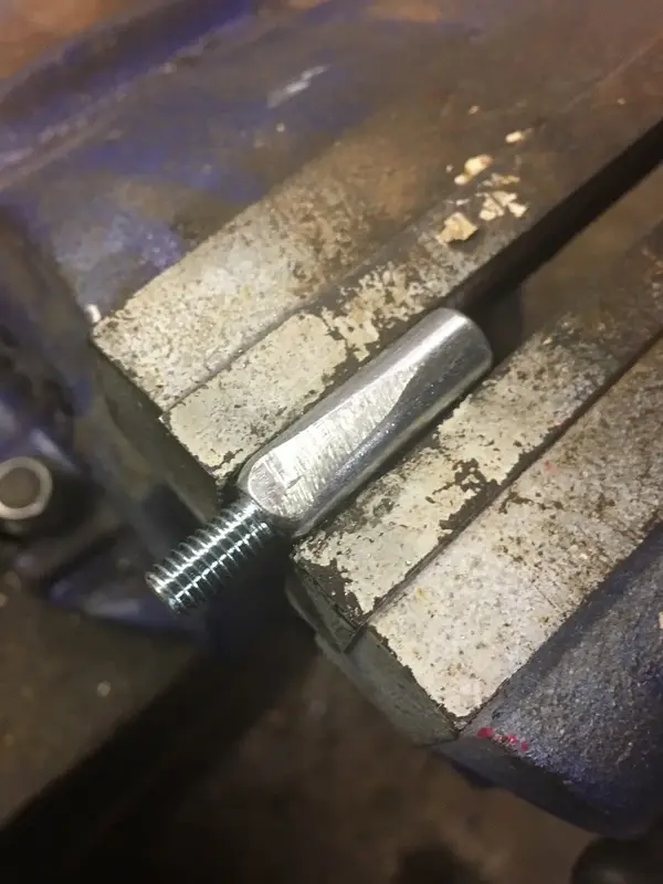

Next 'nice' job in-between cleaning up the nasty Fiamme rims, was fitting the bottom bracket axle and cups, then fitting that big Williams 1/8th - 52t crank, after a few attempts and a bit of cotter-pin fettling, she running nice and smooth and of course super shiny!
