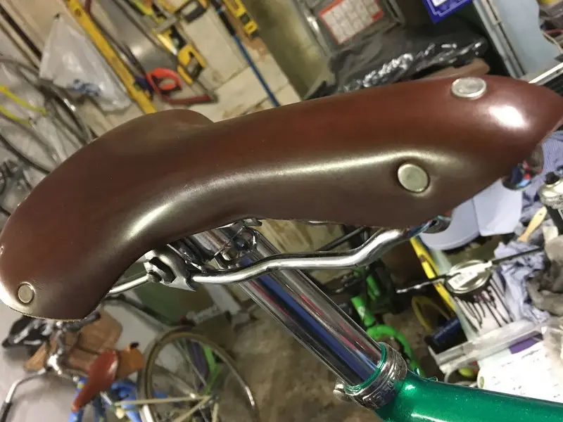

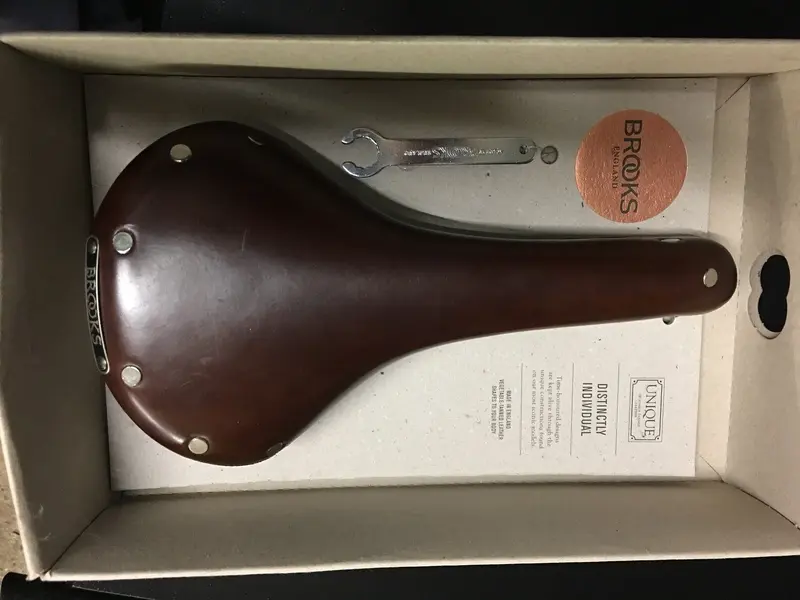

So, to fill in todays slot, here is a Christmas present Lady Peachy got me a couple of years ago… its never been out of the box, let alone fitted to a bike. Just occasionally I would open up the box and inhale…..
Now its on…. Oh yes!

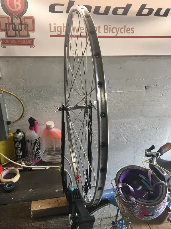

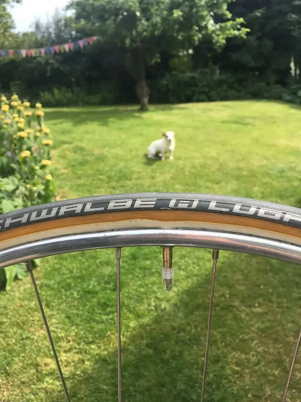

Wheels are in the boot, trued up and ready to roll…. Just need to fit the tubular tyres.. something I have never done before, armed only with a printed off copy of instructions from RB member 964Cup;
Page 2, Post subject:Tubular Tyres. A Beginner's Poll.
Wish me luck......
T– minus (RBotM June) 7 days & counting

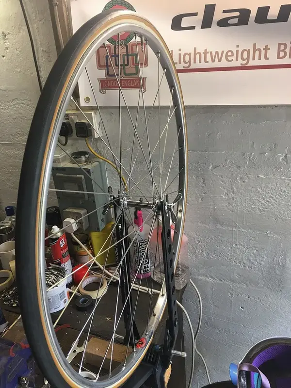

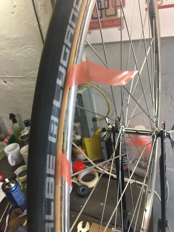

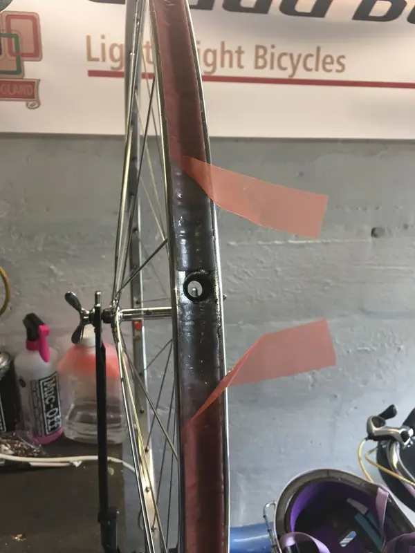

Sorry for the late post today, I’ve been busy in the workshop……
Fitting my first set of tubular tyres, thanks have to go to 964Cup for his instructions & WD Pro for recommending the Effetto mariposa tape/adhesive.
These went on so much easier than I expected, I've heard so many horror stories about how hard this can be… I followed 964Cup’s instructions (see other thread here;Tubular Tyres. A Beginner’s Poll. and all went exactly according to plan.

I have never used tubs.
How do you repair a p******e on the road?
Does the tape allow a 2nd fitting (ie. Fitting spare)?
