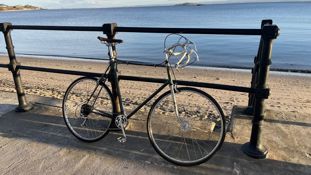

1950 R O Harrison ‘project’

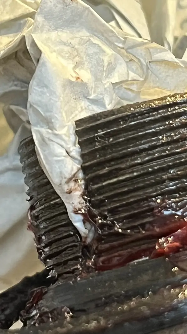

HS - and count your good fortune that steerer along eno' to accommodate it as well :D...quite conceivable it was made this length to accept a clip style set...
This frame post-dates the clip headset era somewhat. There were a small number of manufacturers who persisted with them well into the 1950s, but I don’t think I’ve ever noticed R. O. Harrison being one of them.
The steerer would be a lot longer if it had had a clip originally. The threads would be finer and it would probably still show some sign of having had a tongue cutout if it had been cut down. It would be more likely to see a roadster style headset fitted to a cut down clip steerer, since the threads are the same 👍
Ah
Interesting
Never actually owned a frame with clip headset
Wasn’t aware they used different threads.
Just made an assumption because of the slot
thank you ;)
be statement a reference to the Chater Lea steerer o' 31/32"?

Amazed to find another 1950 ROH frame in a similar ‘state’ to mine!
1950 R O Harrison track, thanks to Eric Charnley
in poor condition, sold as full respray, but i tbink the lining is too good to scrap without a fight, so I'll try to rescue it if possible, worst part is a stripped top tube

Even odder that it has a “stripped top tube”. Mine came with ‘house paint’ on tt. I removed that and found no trace of the original finish.
