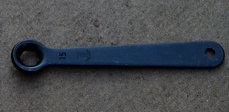

There are much cheaper options though, between Ebay and Halfords you can get everything you need. I wouldn't bother removing the right cup if you don't need to, I'd be surprised if a adjustable spanner will remove it. Normally you have to clamp it in a vice and twist it off using the frame to get enough leverage and not damage the flats.
14mm socket
Crank Puller (make sure you wind it right into the crank arm, if you only give it a few turns its the classic way of ripping all the threads out)
C Spanner & Pin Spanner
The bottom campag spanner (pic with red back ground), is for the bottom bracket cone behind the chainset. This is a left hand thread. If you are going to remove this, undo by turning clockwise.
