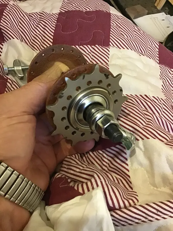

All American single speed bikes were way over geared, all the way to the 70s. It’s a big part of why bicycling became unpopular here. Originally it had a 9 tooth cog. The cog in the photo is stripped so I put it on the non drive side for decoration. I’m working on replacing the original worn out 9 tooth cog cog by removing every other tooth from an 18 tooth track cog. The original cogs were thicker than modern cogs so removing every other tooth is hard on block chains but I have only seen 6 and rarely 7 tooth 1 inch pitch cogs for sale. Here is the stripped cog with the correct thickness. Another photo of the partially finished 18 to 9 tooth cog. Lots of fun. image.jpg image.jpg

That sprocket modification looks fun! I hope you don't have to do too much more!
