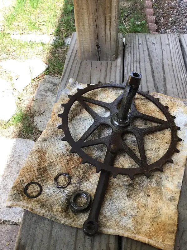

Removing an 1890s two piece crank.

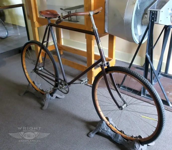

Once I wrestle the bike apart I should make a build forum here? But where. Fixed/single speed or pre 1992 road bikes? I plan to straighten parts and use filler rod on the dents. I’m thinking for paint that a two part black first coat followed by satin crimson. Then fine wet sand and rubbing compound to bring some of the black out, worn look. The black pigment was powdered graphite and crimson pigment was powdered insects. Here is my color inspiration. 21EB8BAD-98DC-4BB2-9787-75DAEF79DBBE.jpeg 54638D58-D2C7-49BB-9754-51964D13BECD.jpeg

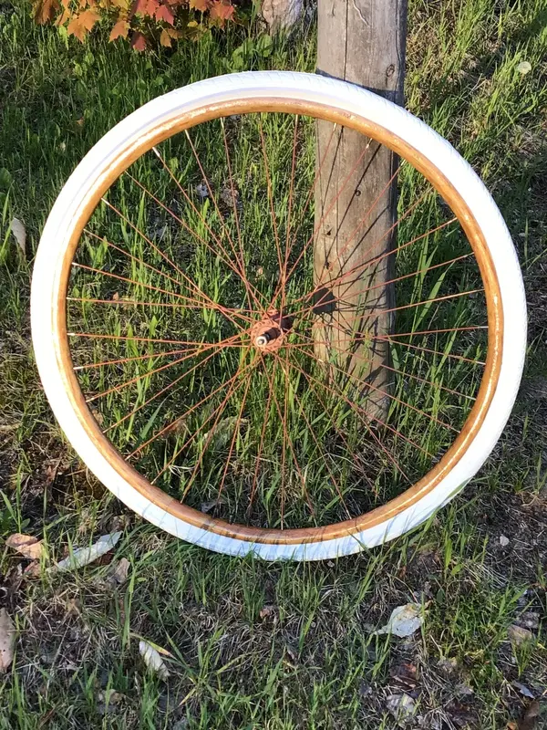

I wouldn’t feel too bad making a build forum here as they were exported in quanty to the UK, so it would be sort of legit. I have another bike similar to this one, a Narrow Tread Racycle. I rebuilt the original wood wheels, but they need too much truing. I have to fiddle with them each time I ride. It’s got a cracked bb race and I haven’t been able to find a replacement. It feels like it has a slightly loose bb, but I ride it anyway. I used it once on an outdoor velodrome when all the elitists were off gluing on new tyres. For the Monarch I’m making faux wood wheels to avoid the constant fiddling. Sacrilege I know but the monarch manufactured hubs are pretty bad and the wood rims have dry rot. The front faux wood wheel for the Monarch is finished.

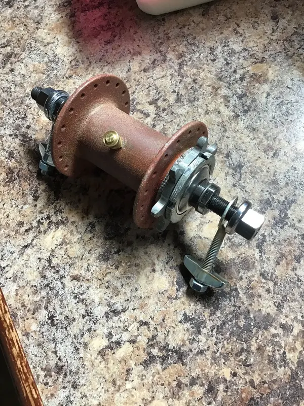

The monarch rear hub OLD is 4 5/8 inches, which is about 3.5 mm shy of 120 mm, so I’m using a modern 120 mm flip flop dressed up and modified to appear old. The chain line should be OK With the 120 mm hub? image.jpg

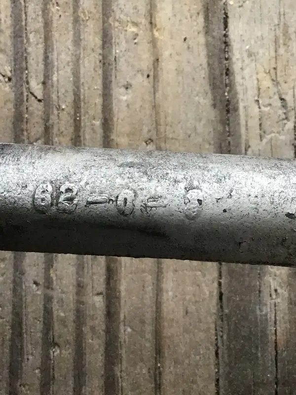

I found a stamping on the crank spindle. 62-0-who can tell? I’m wondering if it’s a date code, June, 1892, first year of production? F46A11FE-6D18-4E44-8995-BB84DC0A907D.jpeg 9258F108-E400-4F22-BB7A-26EB412FFADB.jpeg
