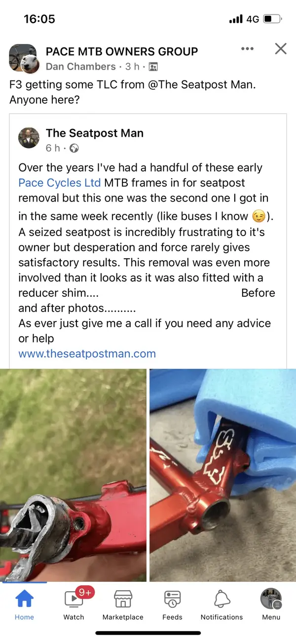

Saw that Pace when I collected my overburys from him yesterday. He isn't a proponent of the the "pull the seatpost out with force" school of seatpost removal - said that you've got know idea how stuck the post is and how much force will be needed so it puts unknown stresses on the rest of the frame and he'd never do that.
he did a great job on mine - the seat tube was clean as a whistle when I collected. Well worth the money.

not privy to the secrets, but there was a massive lathe in the corner of the workshop. nice guy and a complete bmx nut.

I’ve not used him myself but I’ve only heard positive things so well done to him finding the niche
I wonder if he reams them out?
