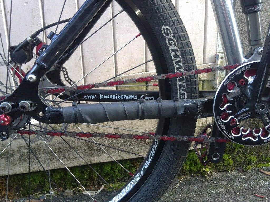

Sliding dropout err sliding.
Have you got this type of dropout?
http://www.chainreactioncycles.com/Mode ... elID=71924
If so, replace the cap head and serated washer with a larger diameter button head bolt and an antishake washer (not as agressive as the facory one), this spreads the clamp load over a greater area. Not had any problems with this set-up slipping on my Explosif.
Let me know if you need pics of the bolts / washers.
No halflink due to my tarty chain!
Was using anti shake washers but to no avail.
Pictures would be good.

cyfa2809":4gins53f said:
Hmm what quite do you mean sir? I thought you meant a full half link chain?
No, one of these.
Just use it with two master links to join it into the chain - far more reliable than a "normal" half-link like this.
I've never had any problems with them.
Cheap too :cool:
Cheers for that.
So whats the actual difference then?
The gusset ones just look like a normal part of chain attached to a half link? Something to do with cranked im guessing?
