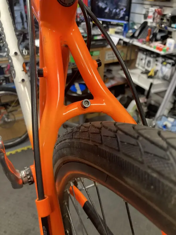

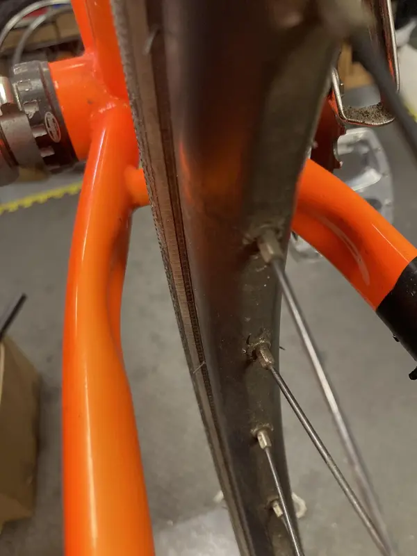

ok, so as it's my day off i decided to go to the shop and start messing about, got the tape measure out against my rocky mountain solo and my old clockwork, reach wise once the correct stem is fitted i think it'll be fine that way. obvs the frame is disc specific and it has a rigid carbon disc specific fork, so i pulled a pair of hybrid wheels out of a customers bike which have 700x35 marathon tyres on a test fit, see pictures, i was thinking 38mm tyres so here's the clearance i have.
fork, no problem at all
rear end i think a 38 might be tight, but i think i'm gonna try it, it's the height of the tyre more than the width that is a potential issue.
chainstay is no issue though

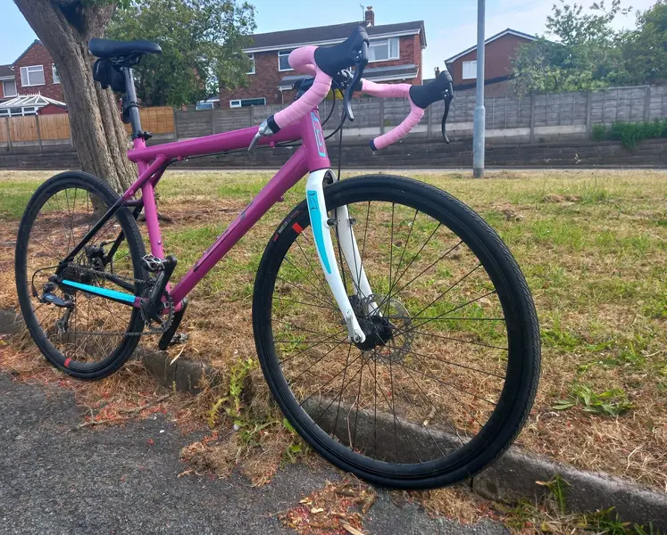

that up there is a 34x11-28, on road it settles out around 16-18mph but can be spun to more, I could go taller on the front and still be comfortable but wanted the lower end too.
