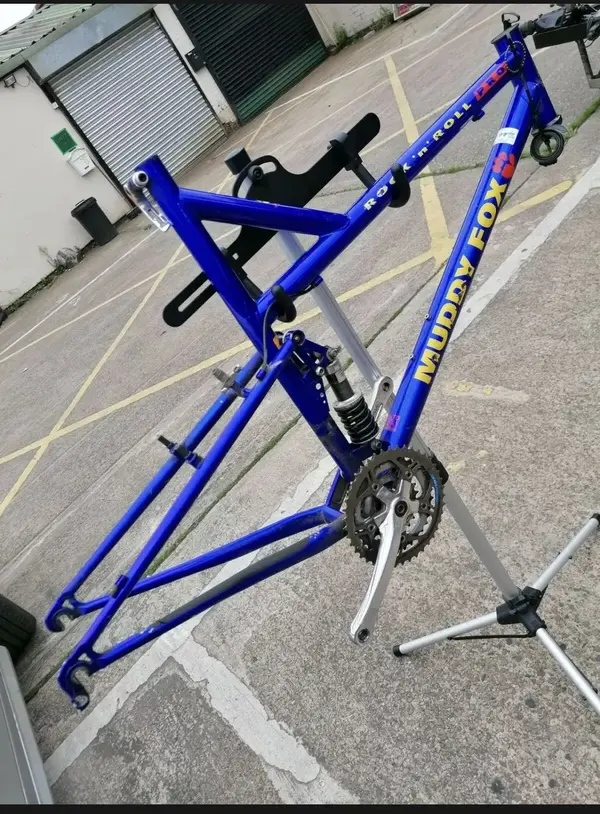

Hope everyone is having a good start to the year... I had this frame in my watch list for about 6 months, finally decided to grab it from the seller...
I don't know why I bought it really, other than I like steel framed machines, I needed another project, and I liked the styling/geometry/linkage design. I have a soft spot for modern flex-stay designs (despite not owning either a Swarf or a Project12 frame).

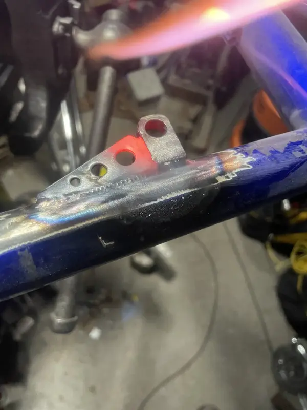

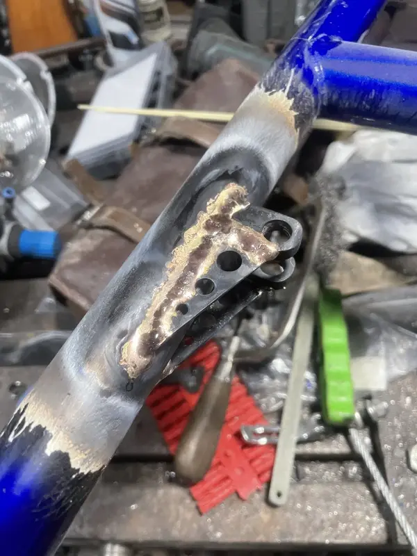

It showed up yesterday. Shock is dead, shock hardware is all bent and the rocker mount on the seat tube has cracked welds. It's a good job I have a tig welding shop, although I'll fillet braze these repairs to add some reinforcement to the pivot area, the welds all being underfilled.

Does anyone know what date this is, roughly? I’ve tried researching as much as I can but it’s hard to find details on these later muddy fox designs

I saw these in the shops all those years ago, would have been around 95-96. Attached pic is a slightly later Rock n Roll Ultimate I have, although it’s in bits at the moment and is actually pretty heavy. I’m currently building up a Alu Ultimate. I’m sure when I saw these, think they had LX/XT and Rockshox forks, something like a Quadra 5/IndyC/XC.

Was this design of rear triangle and rear suspension the later design, when compared to mine?
Yes, this would have been the later, think from about 97 onwards, but can remember the two designs running side by side in the line up - the design of the Pro was lower down the range and the Ultimate was higher up. There was also another design where you could alter where the shock was fixed to alter the head tube angle and possibly the travel, was used more for DH also. Some had nice specs.
Very interesting, thanks.... The build quality is interesting - the welds are a bit rough and are all underfilled and/or undercut, yet the engineering seems quite good, nice needle roller sleeves in the rear pivot for example.
