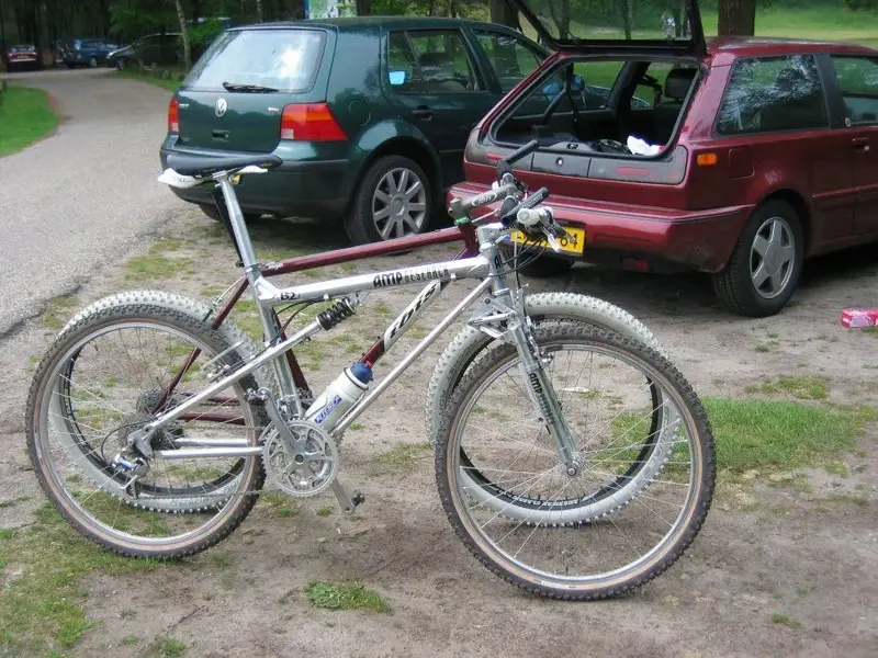

Here is a pic together with my Ibis '01 just after it's maiden ride with me...
Some things are gonna chance in the near future and I'll post some pics of the details soon..
It's a bit flexy on the road, but in the dirt this isn't a problem I know now

i like what you've done, the silver ringle kit is good. i'd be tempted to put the white tyres and a white saddle on that! ;)

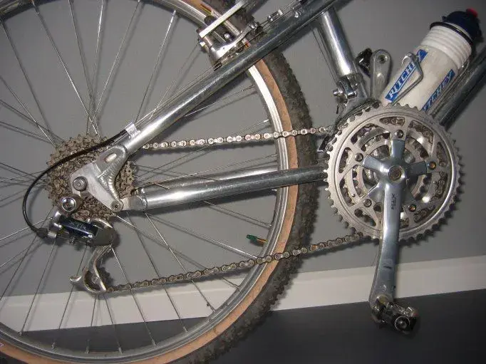

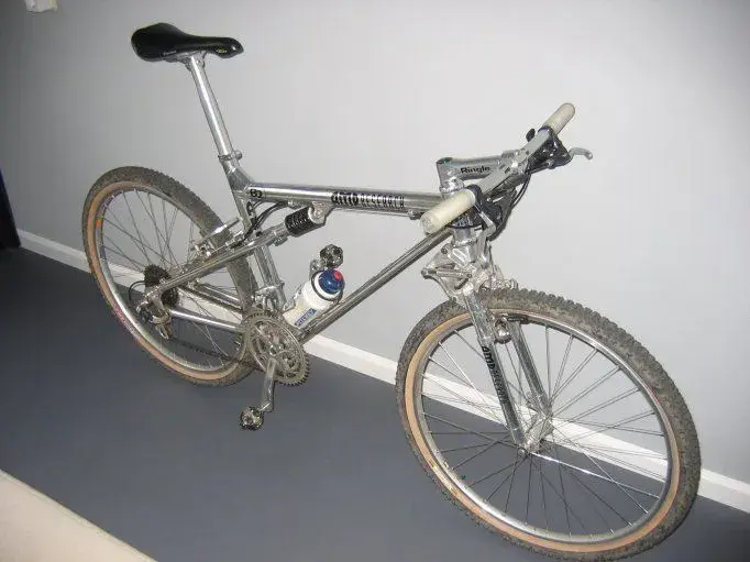

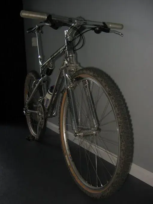

...latest pics with a few detail pics...
Thats looking stunning :D some outdoor pics please!

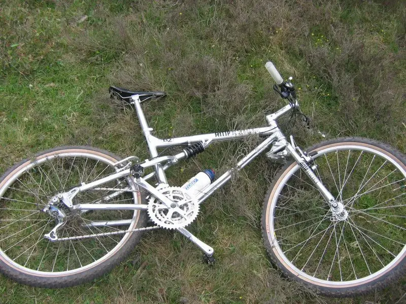

Here are some pics of the meeting we had last year...
Not realy action pics, but it rather difficult cycling while making a picture of it..
