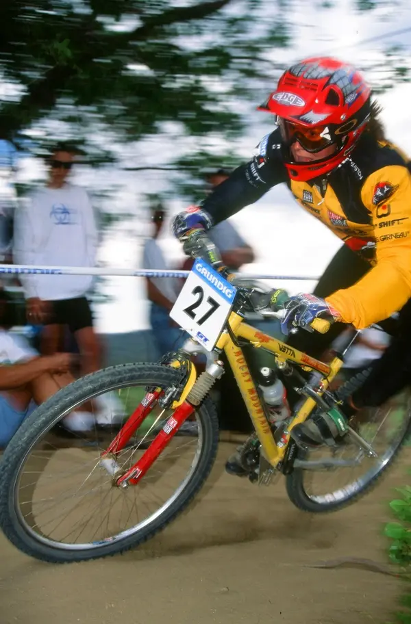

This one is from the Rocky Mountain Facebook site, showing it in use at a DH race.

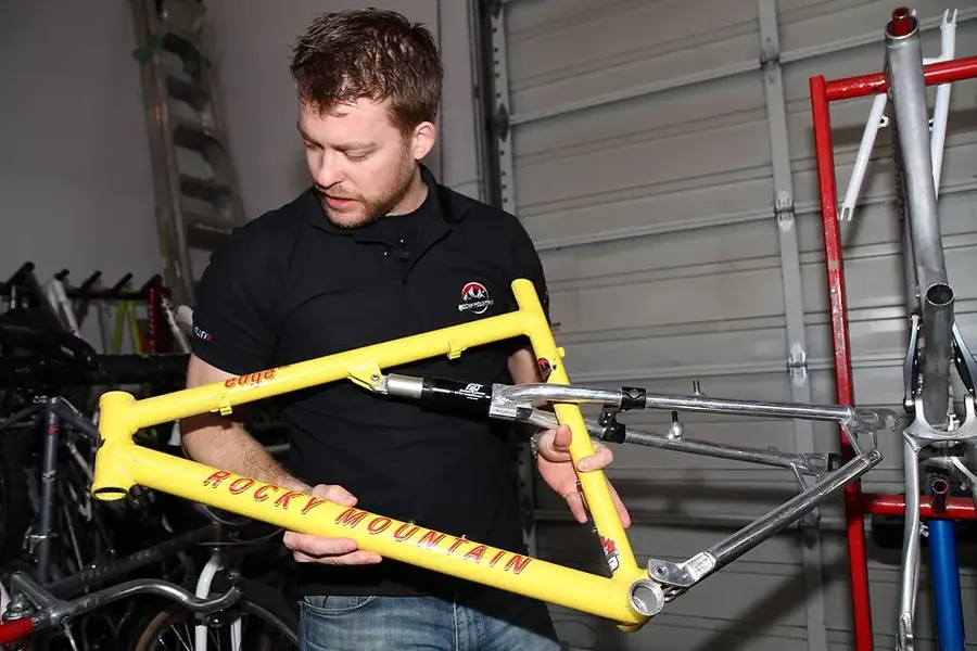

And last but not least, not sure about the exact source of this picture, I think it was a recent article where someone made a visit at the RM HQ.
So even Rocky Mountain seem to have this frame still laying around.
