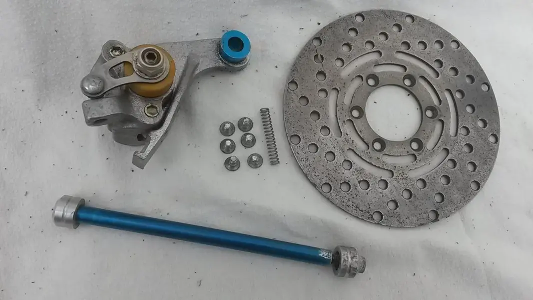

The mount on the rear(red bike pic) is radically different to the mount on the front, or rear of this set.
This is it.
