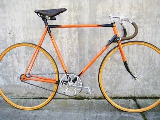

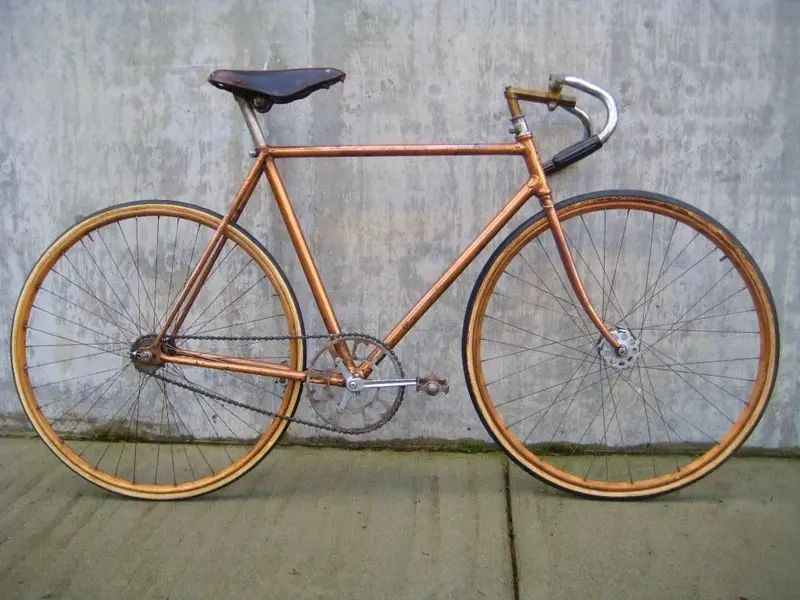

More eye candy from; http://classiccycleus.com/home/repair/bikes/
Just incase its been shot blasted and powder coated by a "fixie Boy" a suitable paint scheme will be required…..
Anyone like this ?
Or if not, copper plate ?
Pretty impressive looking machines from the 20's and 30' I reckon.
