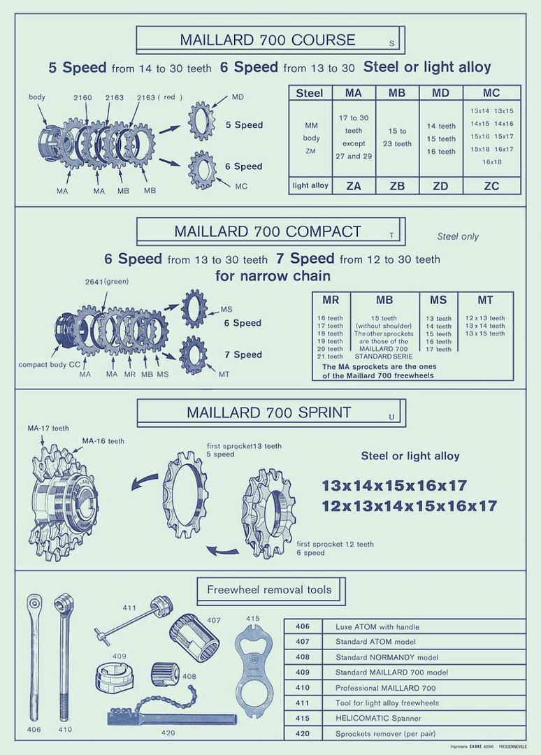

9 ) FREEWHEEL
There were several french manufacturers of freewheels namely : Atom, Maillard, Cyclo
But at a stage some were swallowed by others but the make names still existed so it’s a pretty confused scene !
On the scale passed steel freewheels
A Cyclo 72 5V is 294g
An Atom 5V is 327 g
A Maillard Course 5V 381 g
But at a stage Maillard made an effort for a light freewheel.
It was manufactured in alloy - sometimes dubbed Zicral - easily recognized as with a bronze or brown color
Maillard Catalog
The result was amazing !
The body alone is 80g and the 5V I build is 172 g - an enormous weight gain. It will therefore be mounted on the wheels of this full french light

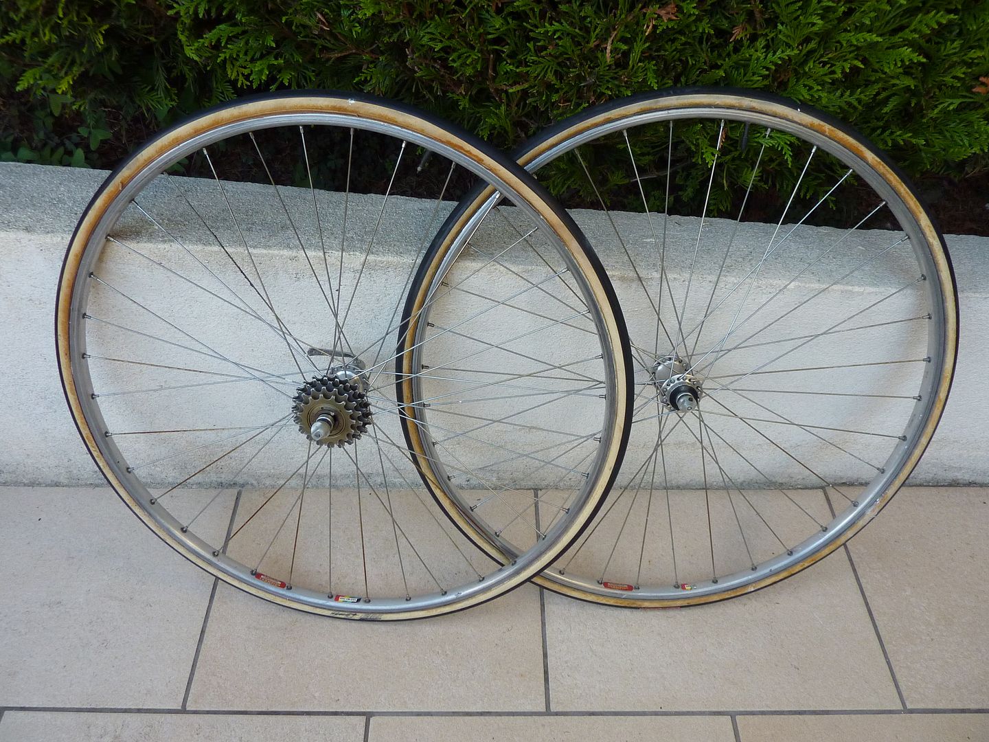

The wheelset chosen finally is equipped with rims Super Champion Competition Arc en Ciel on very classical Mavic sealed bearings hubs (desctibed earlier on in the hubs part) and period Wolber Neo Pro tubulars.
The hubs are actually Mavic 500, the very first version of these Mavic hubs which became leter the 501
The Arc en Ciel is not the lightest rim from Super Champion but reasonably light at 345 g ( the Performance was 305 and the record du monde 330g)
The weight is really an enormous progress on the clinchers !
Front with skewer is 1060 g
Rear with the Maillard Zicral freewheel is 1260 g
Comparison with another set of tubulars was done
A pair of Mavic Special Sport on Normandy Luxe Competition small flange hubs with skewers and Schwalbe Montello 300 and same Zicral freewheel is
Front Wheel 1130g
Rear Wheel 1390 g
For info Clinchers weighed previously ( Module E on Pelissier 2000 professionnel and Michelin Bib) and same freewheel
Front Wheel 1250 g
Rear Wheel 1570 g

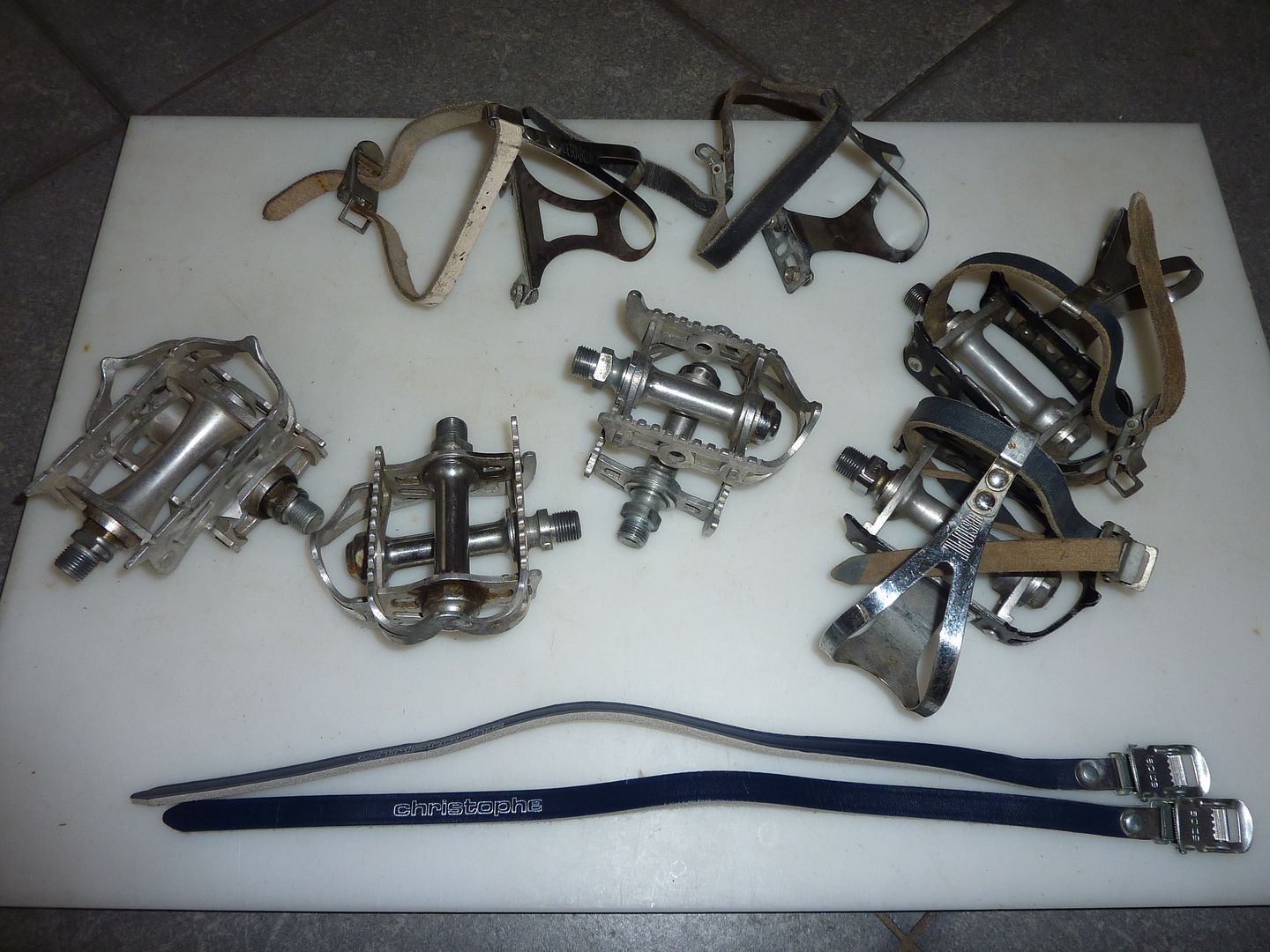

So in my stock, I digged out a few pairs , one all alloy and which may be Lyotard 45ter but the dustcaps are not signed so they are probably French copies. They weigh 143 g : tempting
Other Maillard or Lyotard models are 158 or 162 g and Maillard 700 with toe clips and straps 460 the full pair
For the moment I am not really decided – will choose at the last minute I expect. Possibly the lightest :mrgreen:
Toe clips and straps will either be Gerardin or Christophe, the ubiquitous equipement on all French road racing pedals. I ll probably go Christophe
What do you fancy - black or blue strap – here on pic a dark blue NOS pair. :?:
Here are the potential pedals , toe clips and straps candidates.

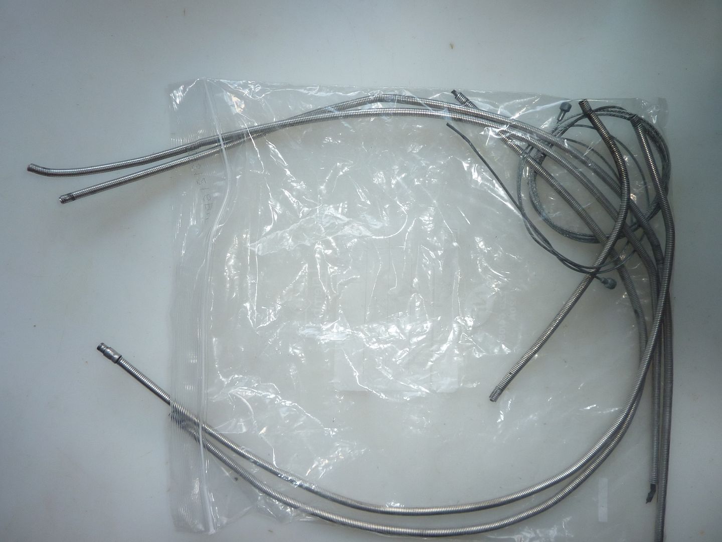

CLB Housing
Again there isn’t much choice in the lightweight housing for cables available at that time
The CLB housing without plastic cover in alu
Here an original selling wrapping – It is advertised at 85 g
Mine recovered on old studs
