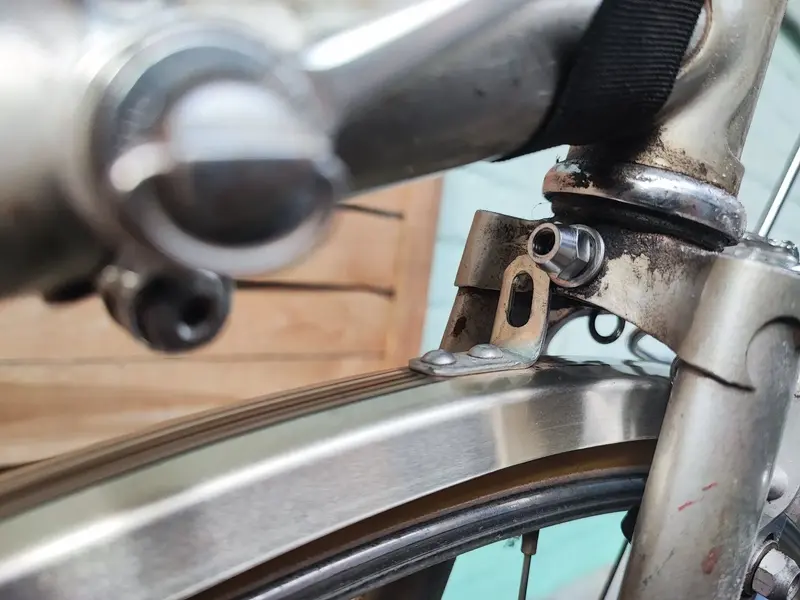

I now have mudguards, but I will have to modify the metal thingie because the brake caliper spring is in the way, so I have to get a longer bracket to lower the mudguards. 🤷‍♂️

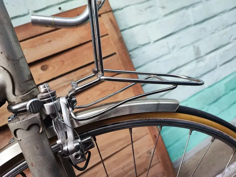

I have a nice (to me at least) small front rack for a small front bag... Except it does not fit near the fork because of the brake caliper, so I tried this risky mount.
It will have to go on another bike, I'm afraid. 🙄

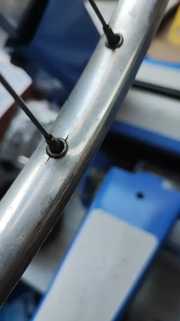

I also have a dead rim. 😭
