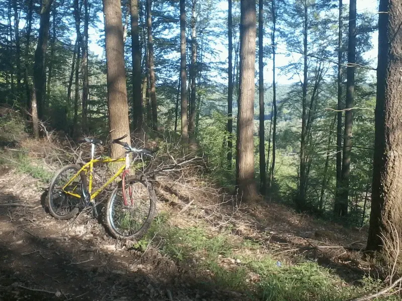

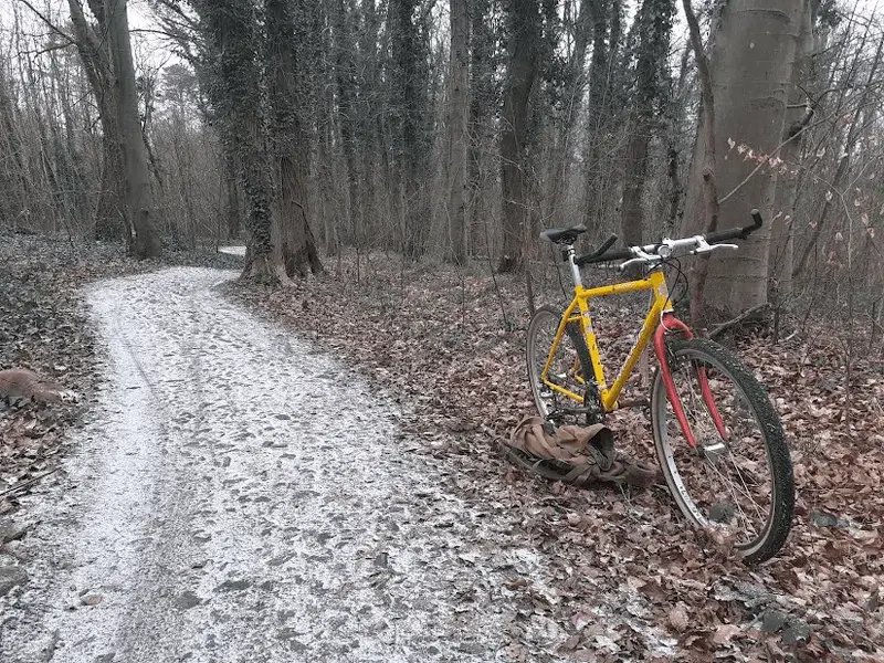

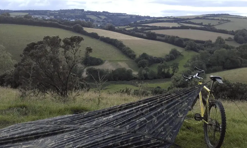

As original - complete with terrible terrible RST 181 elastomer sprung fork, and (the shame) riser bars with bar ends

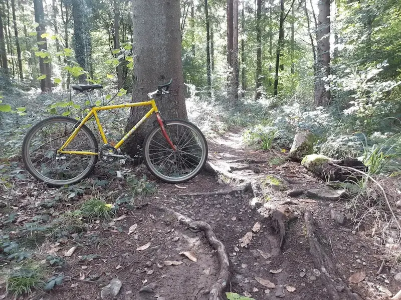

The RSTs were so bad I swapped them out for a rigid fork, which was a big improvement. Did a lot of riding on Exmoor & Dartmoor like this. The rest of the bike was still pretty much stock, running 7 speed STX with grip shifters.

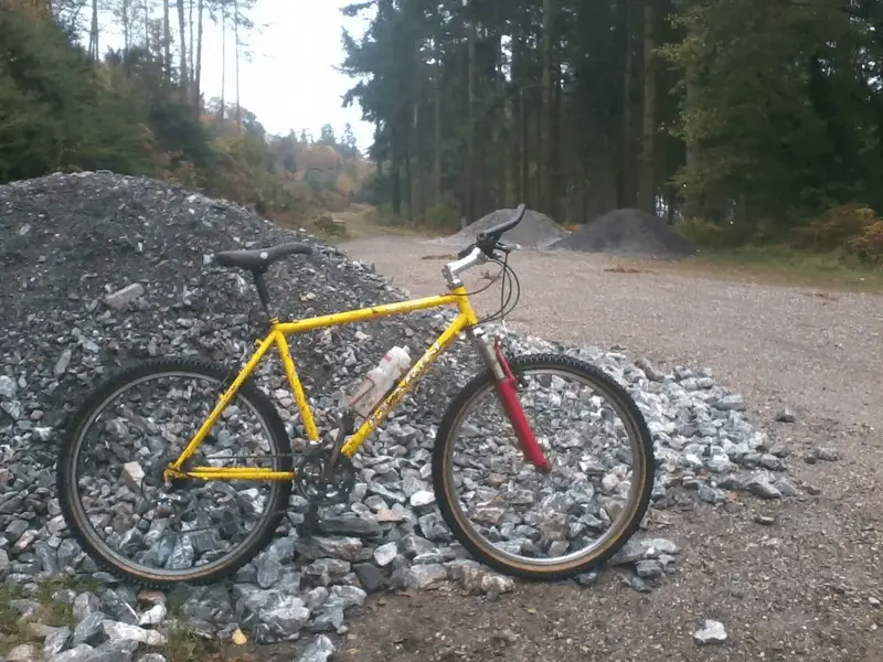

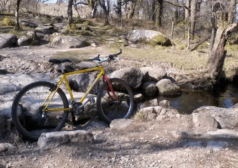

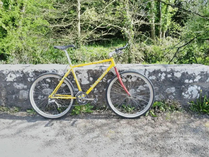

When I got a more modern 2010 GT Avalanche, the Marin was retired for pub bike duties as a single speed... briefly! I didn't get on with SS, so popped the front mech back on and ran it as a two speed, with slick tyres, and flat bars. Was also a blast on tame MTB trails!
Later on, I put some proper knobbies back on, stuck on a slightly more modern STX-RC 8 speed drive train, and used it as a "stick in the car for a quick spin after work" bike.

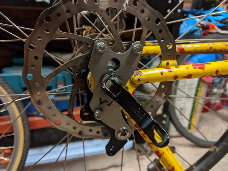

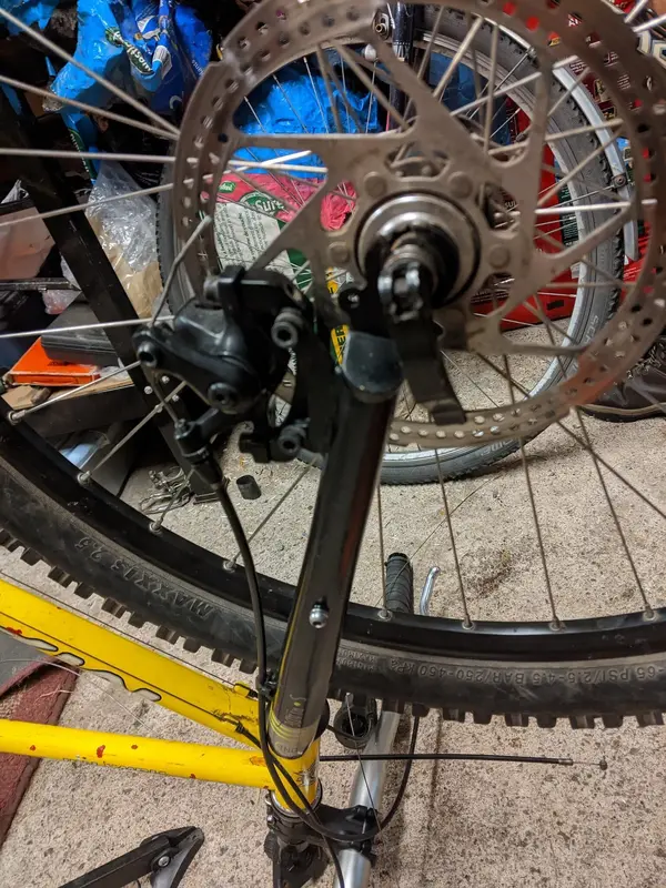

The rear disc adapter. I think all it needs is a bit of aluminium plate cut to add some height to the seat stay, and some washers to prevent the outer plate from bending when tightened down. In the worst case, the IS tabs may need filing to get the caliper alignment spot on.
I suspect getting it just so will take longer than it feels like it should, but it'll make a nice bit of rainy day fettling.
This is the aspect of the build I'm least confident of, really hope it can be made to work well.
