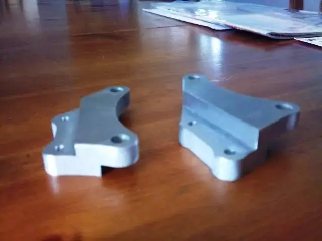

I'd like to run the Amp D1's or Formula R1's. My biggest problem is I don't have the adapters to run ISO calipers on this frame and fork. It's not like I can buy them anywhere :( .
These wheels are so pimp it's got me thinking RetroMod!
I know what you mean, I ended up making loads, the next batch are going to be post mount. bike looks great by the way. :cool:
Dibs on a set of post mount disk adapters for me please.
I'm not sure I could talk myself into putting R1's on it but, I already have them so I'd certainly want to :D
Cheers
