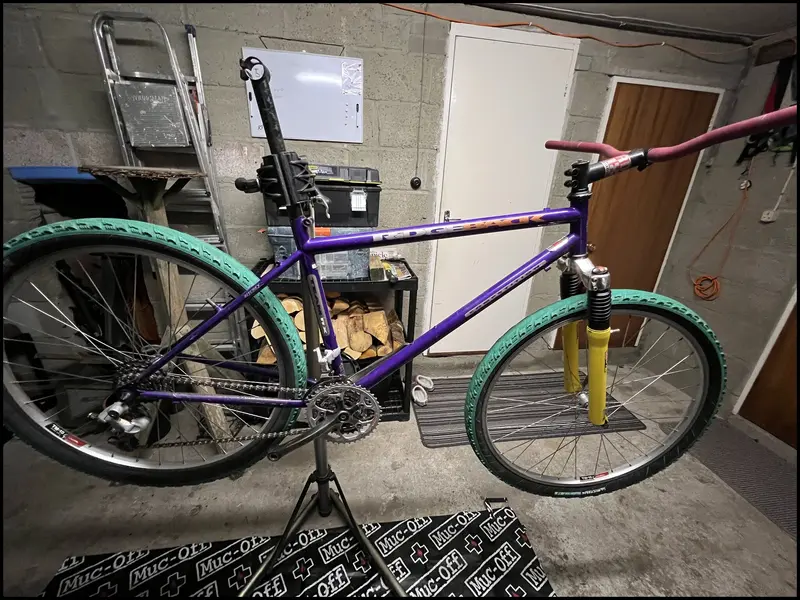

This left me stripping the rest of the bike and boxing them up for a later date.
February this year, I was just browsing EBay while having lunch at work. Then I found them, a pair of 1995 Rock Shox Judy SL’s with a 1” steerer, they did come with a red v-brake brace, and not the yellow cantilever brace I needed, but I could deal with that later. (Later given to me by the kind EBayer when I picked up the green DCD from him).
It was great to see forks and a front wheel back on the bike after many years of just a frame and rear wheel hanging up in the garage.

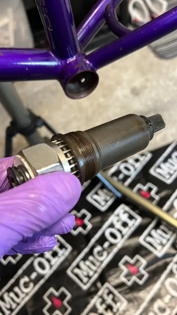

Now I had the forks, the only big issues I could see was removing the seat post and bottom bracket from the frame. I concentrated on the seat post first by squirting with WD-40 before riding to work, then turning the frame upside down and spraying into the down tube bottle cage holes in the evening. I eventually removed it, it didn’t look healthy, and also I needed a new saddle, so I replaced it with the X-lite post as well as getting the Planet X saddle.
I was concerned about removing the BB as I wasn’t sure if it had ever been removed.
I followed the same routine as with the seat post, and by the weekend I was ready to try and remove it. To my surprise, the plastic drive side retainer came off with no problem; the non-drive side was a different story.
My Park tool BB removal tool was to long to fit any sort of bolt into, to help keep it in place. After some research I found that the Halfords BB tool is stumpy, so you can put the crank bolt into the end to lock it on, after a bit of help from a breaker bar I managed to remove it.

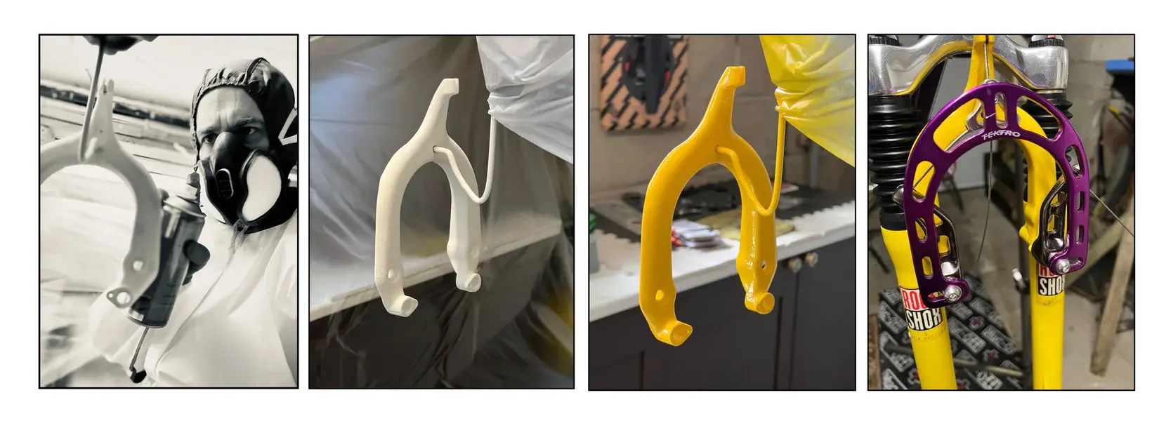

My original idea was to get new decals made and respray the frame. But after reading a post by @ededwards, about when to respray or not, I chose not to respray and preserve the patina, which having this bike from new is my history riding the bike. The only part I was going to re-paint was the cantilever brace, I read on RB that the Fiat Broom Yellow colour was a close match.

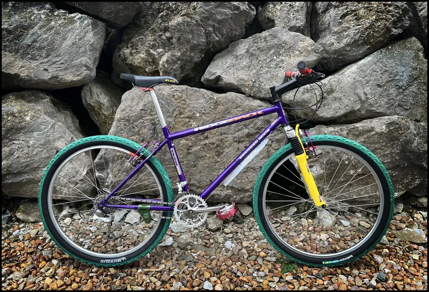

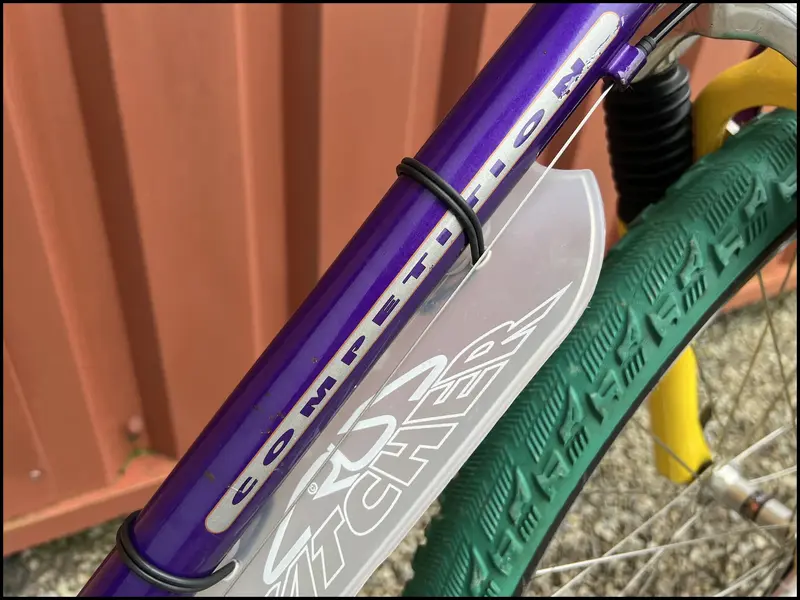

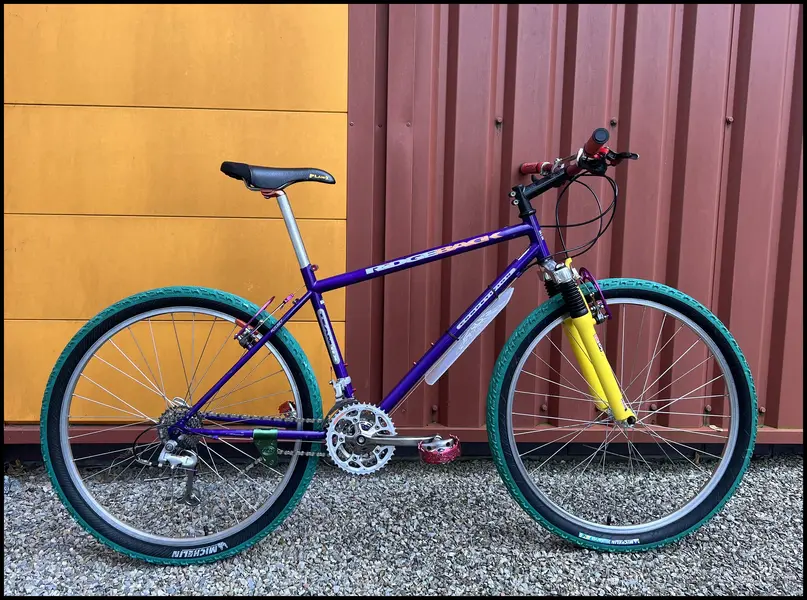

I’ve really enjoyed rebuilding the bike; it has jogged a lot of great memories.

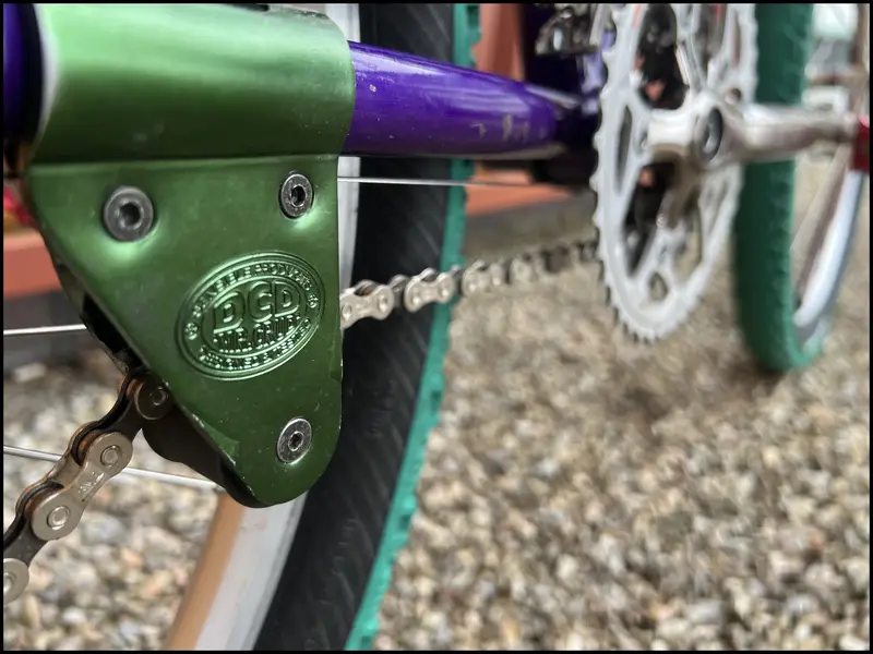

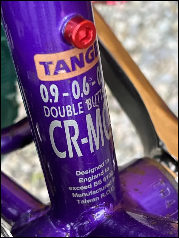

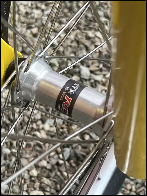

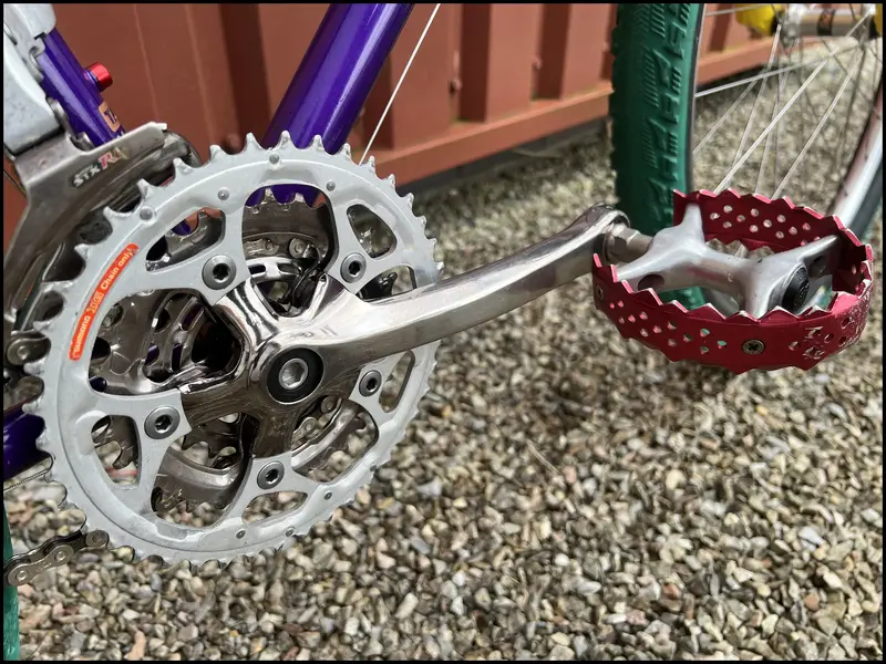

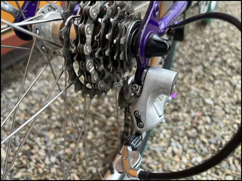

I intend to go for a ride soon, but i'll put some different tires on to preserve the Wild Grippers that are starting to show their age.
