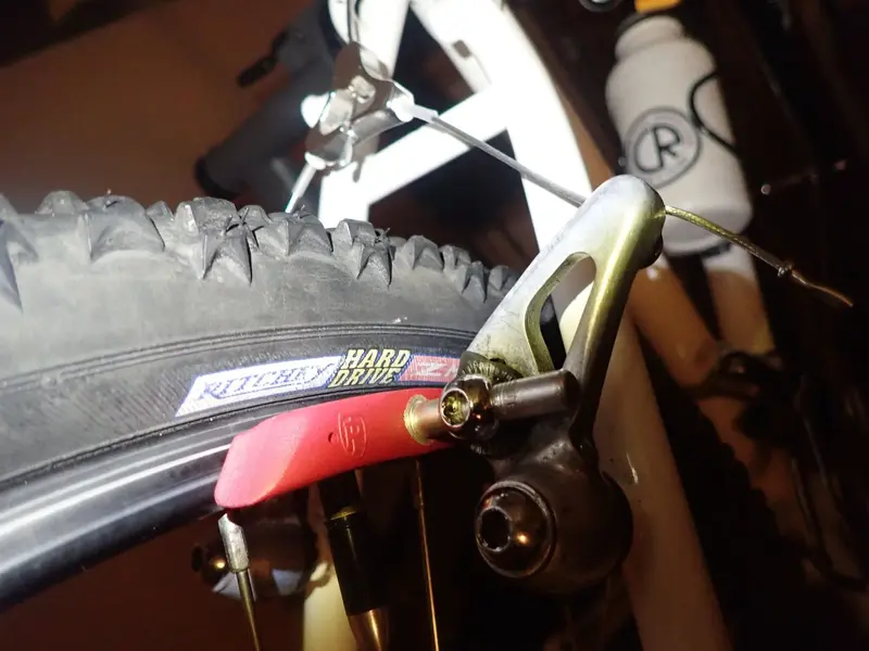

In the mean time I've deep cleaned the XT canti's
Before...
After...

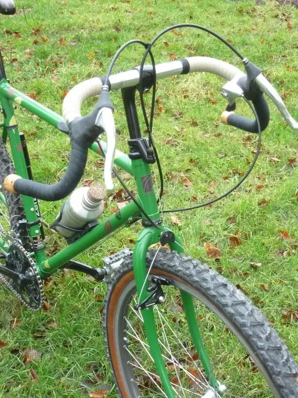

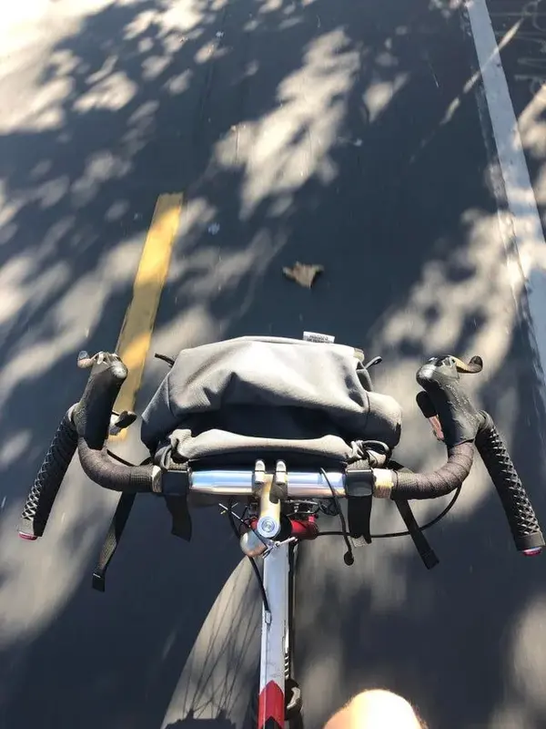

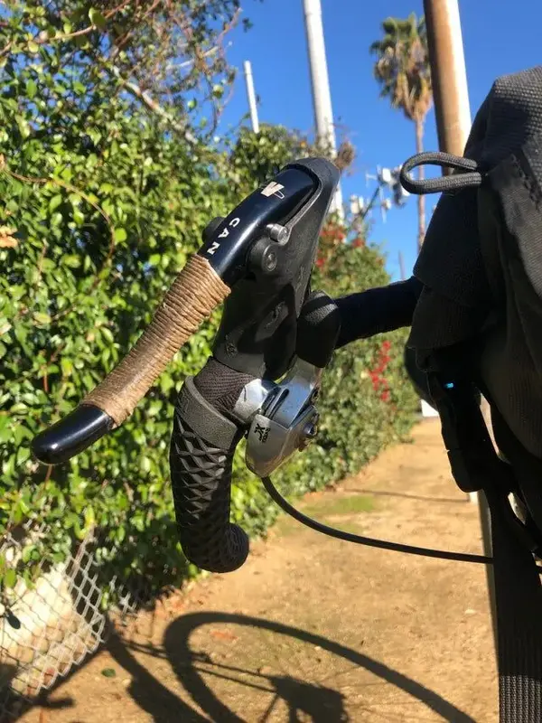

If you can do without indexing, straight XCs are perfectly doable, although it takes a bit of getting used to.
Cool double color wrapping job here!
Your setup could also benet some sausage Link repro plates :) But it seems you are riding more the hoods so it should be all fine.
Before...
Found attached pics on FB somewhere..
Yeah its also possible in different ways just plain simple
Nice bike! And yes it's thumbies over triggers and friction over indexed for me given the choice, my hope was to try and get the m900 triggers fitted simply because it looks slightly more comfortable and the DKG's came along at the right time. It's likely that I'll do something similar to your set up though, at least in the meantime, so thanks for sharing that.

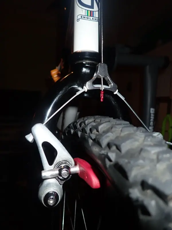

After drying them out I fitted the cantis and assembled the straddle wires in readiness for the final assembly, going with Ritchey cold weather pads, red wouldn't be my first choice but it seems to work well with the bottle cage bolts and little flashes of red in some of the decals, will swap for blacks in the spring mind you. Wouldn't mind some black cantilevers either 😉

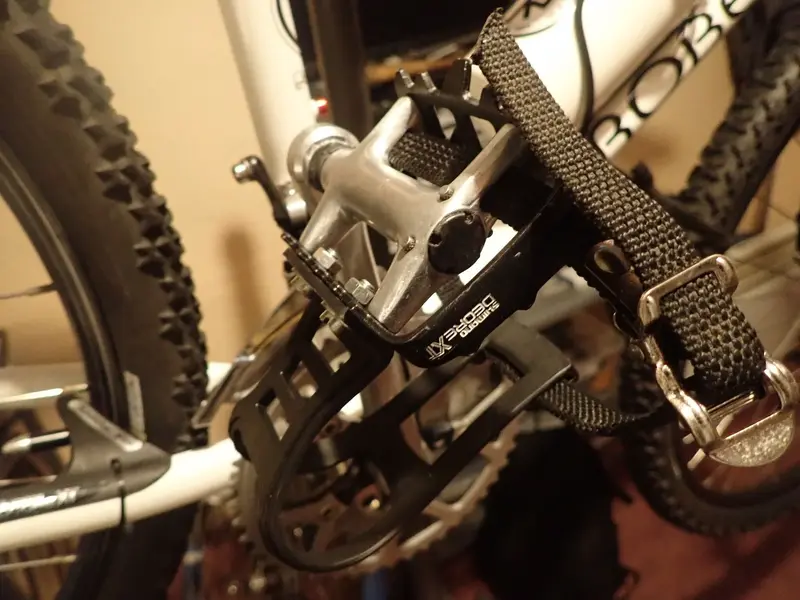

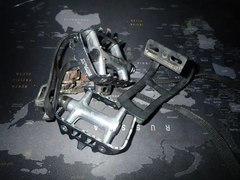

Finished the pedals, the bearings are spinning smooth and fast so no need for a full strip down, just a cosmetic clean and tidy up.
Before
After
And fitted
