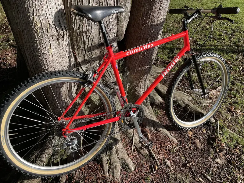

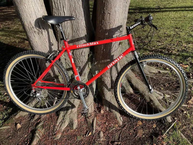

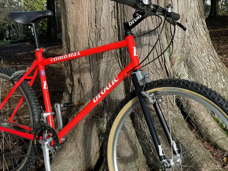

When I purchased this brodie in May this year it was a complete bike and a decent build already. It’s been through a few different setups the last few months, each version getting closer to what I consider perfect for my taste.

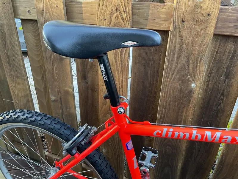

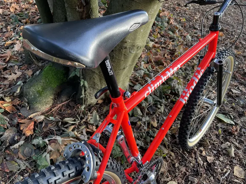

The silver frame decals it came with were very cool and not that often seen. I had noticed they were applied in recent years though and not original as there were paint scratches under them in places. Even right after buying the bike I had wished it had come with white decals. The fellow who sold it to me heard a rumour Paul had applied the silver decals himself and I had also found out it had come from a good friend of Paul’s. Chatting with Paul at a recent swap meet though he could not recall and thought it unlikely.
Earlier this week while admiring my favorite vintage MTB I thought “why haven’t I swapped these decals to white yet?” 😁
I knew I could source a set from jimbo but lucked out and found that @vintageman had a spare set he didn’t need and I could get my hands on them sooner. Stuck ‘em on the same night!
For my taste the frame looks perfect now. The white matches the stem and fork decals and stands out better, I found the silver disappeared into the neon red a bit.

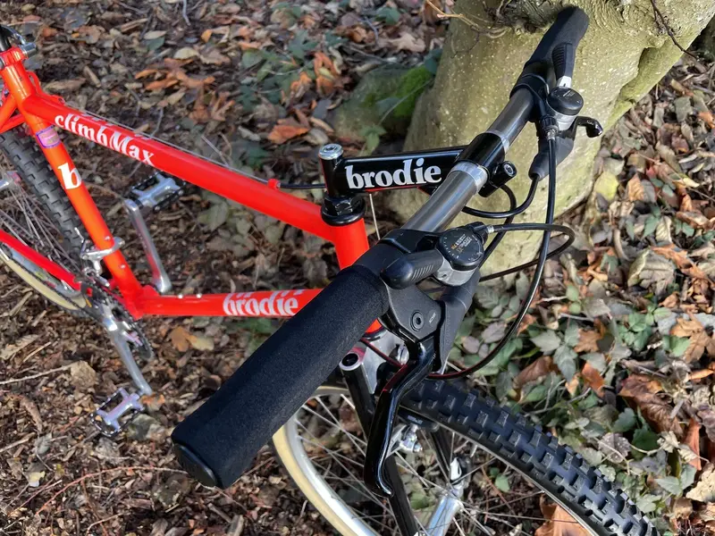

Another recent swap is to a Bonty/Titec Ti handlebar, logos were pretty worn and I thought a logo-less bar suited better anyway so off they came

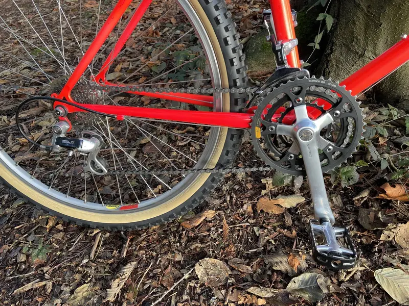

XT cranks were previously polished to a mirror finish. A common process for me on builds where cranks are in rough shape. I never loved the mirror finish though but up until recently I didn’t have a better solution. When polishing the cranks for my Blizzard build I decided to go back with 3M 3000 grit post polish. It gives a more muted satin finish. I love it. All my polished cranks are not de-polished down to this more satin finish.
Oh ya, may as well mention that under those XT crank caps are some sweet Titanium crank bolts, a frivolous recent purchase made locally through Marketplace for a very reasonable sum, thanks Nick! Dropped at least 10g I’m sure :LOL:
Updated build spec below photos, it has changed quite a bit compared to the previous build spec posted.
Yep, I’m done :cool:

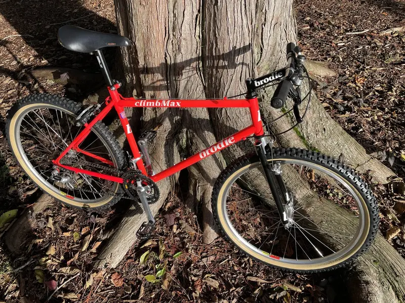

Finished build spec:
Frame: 1988 Brodie ClimbMax (Frame # 478 19” Tange MTB 4130 Tubing
Fork: Brodie Gatorblade
Headset: Deore XT HP-M735
Stem: Brodie TIG ICR 140mm
Handlebar: Bontrager Titanium
Grips: Ritchey WCS TrueGrip
Cantilever Brake: Deore XT BR-M732
Brake Pads: Deore XT
U Brake: Deore XT BR-M731
Brake Pads: Deore U Brake
Brake Levers: Deore XT BL-M733
Shifters: Deore XT SL-M732
Front Derailleur: Deore XT FD-M735
Rear Derailleur: Deore XT RD-M735
Cassette: Shimano CS-HG41 11-28
Chain: KMC
Cranks: Deore XT FC-M730
Crank Bolts: Titanium
Chainrings: Shimano LX (black)
Bottom Bracket: Deore XT BB-UN71
Pedals: Deore XT PD-M731
Hub Skewers: Deore XT
Rims: Mavic 217 (36H rear, 28H front)
Hubs: Shimano XT FH-M732 (rear) Real Design (front)
Tires: Rockstar Sierra 26x2.1"
Tubes: Maxxis Ultralight
Saddle: San Marco Rolls Titanium
Seatpost: Deore XT 27.0
Weight: 25 lbs 14oz
