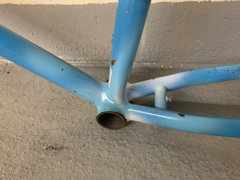

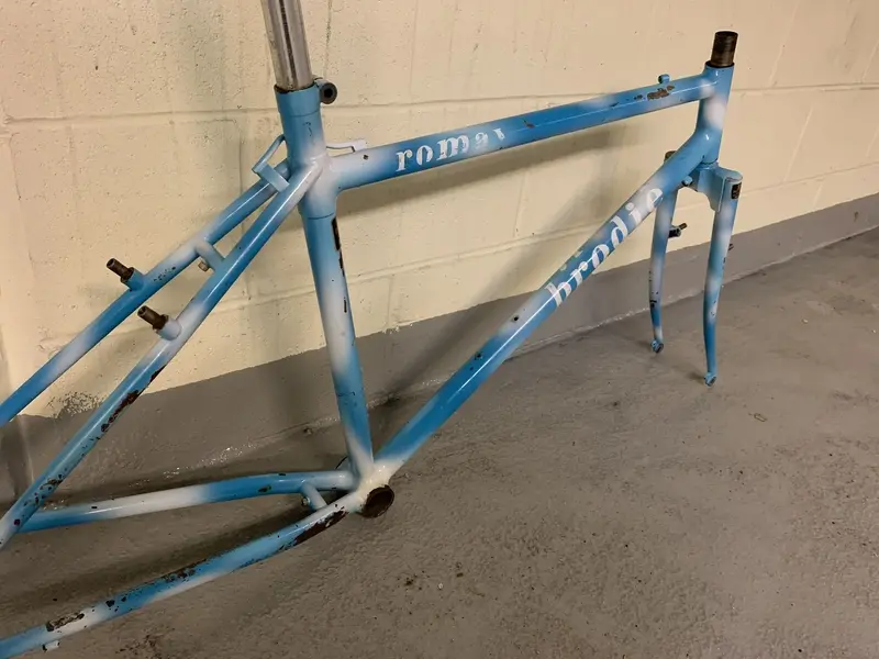

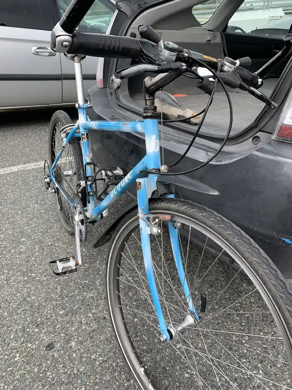

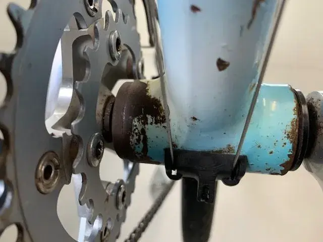

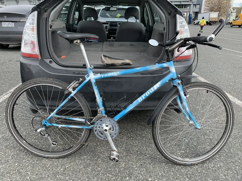

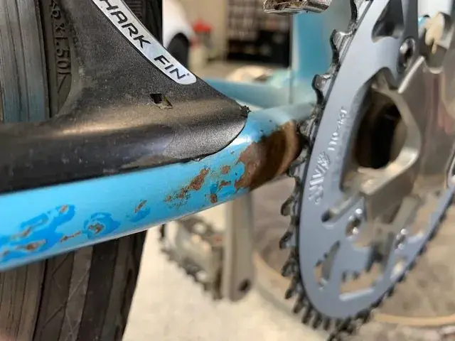

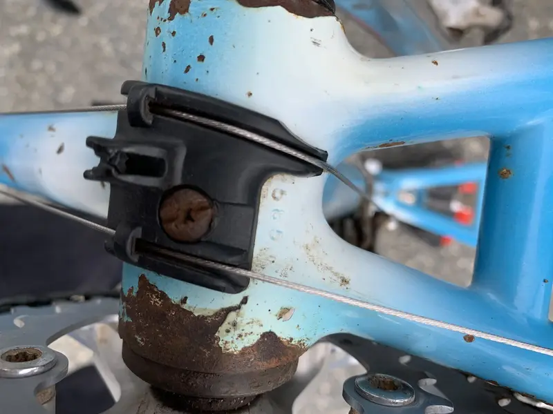

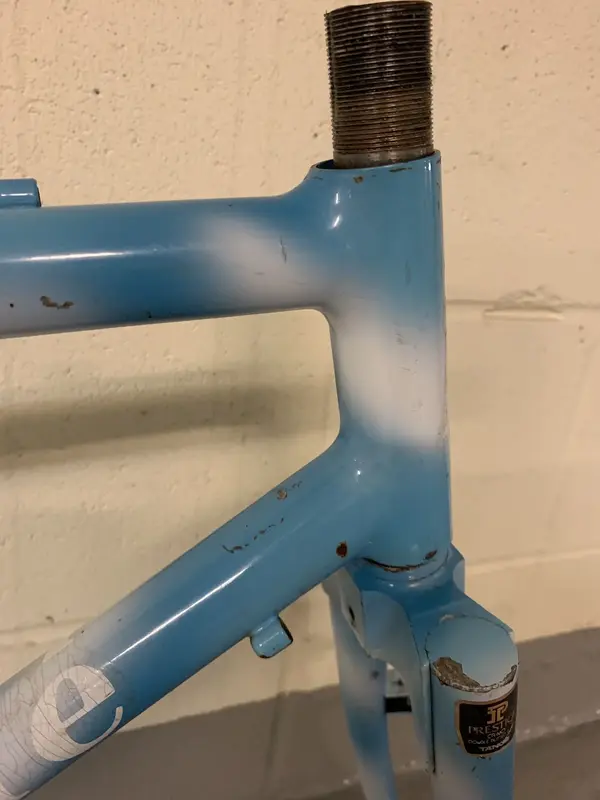

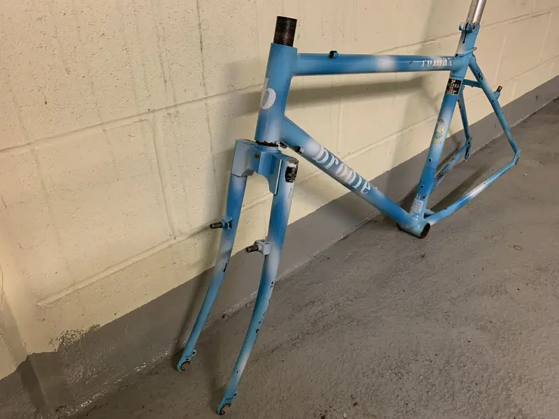

Now onto the less-than-ideal part… It had a lot of surface rust, considerable paint loss, a seized seat post stuck wayyyyy down, a seized bb and a bent derailleur hanger. All solvable stuff really, the great news was that there was no actual corrosion. All said, there was no way I could pass on it and I’ve really enjoyed getting it back on the trails after giving it a lot of TLC. I guess I’ll quit rambling and post some photos 😅
As found:
2948BA9E-31B3-498F-B95D-3DF18890762B.jpeg 2F92003B-0997-4E4F-B78F-DD19A78E4869.jpeg AACF29E4-9096-420D-A368-BE8FA8EF68CD.jpeg 9257CE04-A748-456F-B5D1-72FD07FCABFE.jpeg FAEF238E-40A9-419D-8260-8DB789412A7D.jpeg 669D85E0-34FE-41FD-9DF7-8D904B99C0B5.jpeg EB85A35C-F372-46C8-8733-121E5749CEFB.jpeg E358BD7D-990C-45F8-82C9-5C0B233BD164.jpeg

Here’s a quick peek at how I handled the surface rust. I used a dremel with some soft brass wire attachments that blasted all the rust away while not affecting the paint. I felt that touch ups were out of my capabilities so I opted to cover the bare metal with clear nail polish. Not at all bothered by the patina.
