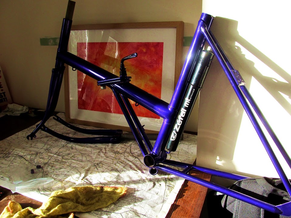

I need better to light to capture the candy colour, but I picked the parts up from the powdercoaters this morning and I'm delighted with the colour and finish:
