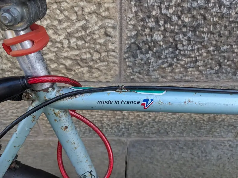

I spotted this 1985 Peugeot PH501 for sale locally for £30.
The listing described it as 'Very old road bike, works fine'.

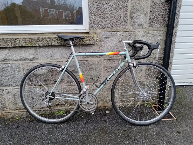

Between the non-functioning brakes, the horribly out of true back wheel (probably contributing to the former) and the severely indexed steering there wasn't much on the bike that was working fine. Worryingly the previous owner had been commuting on it too. However I was looking for a project and happily parted with my £30. The bag of cleaning products and the fairly fresh tyres that came with the bike was consolation that it wouldn't be entirely wasted.
Here's some photos of the bike the day I picked it up.

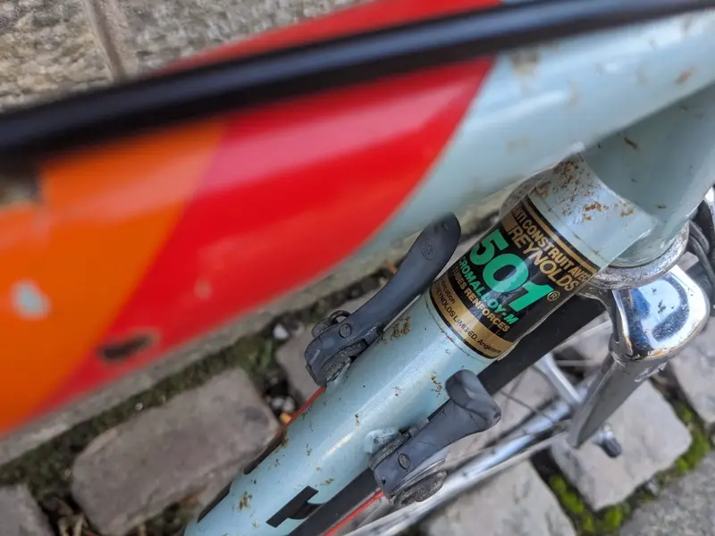

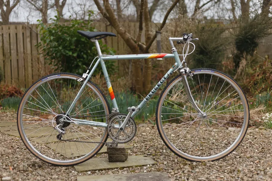

Plenty of patina!
I fully stripped the bike and built it back up, trying my best to spend as little as I could (at least initially...) rebuilding the original headset & bottom bracket.
The original back wheel was unsalvageable, not least because the bearings were sitting open to the elements, so a new set of wheels from a bargain seller on eBay was purchased.

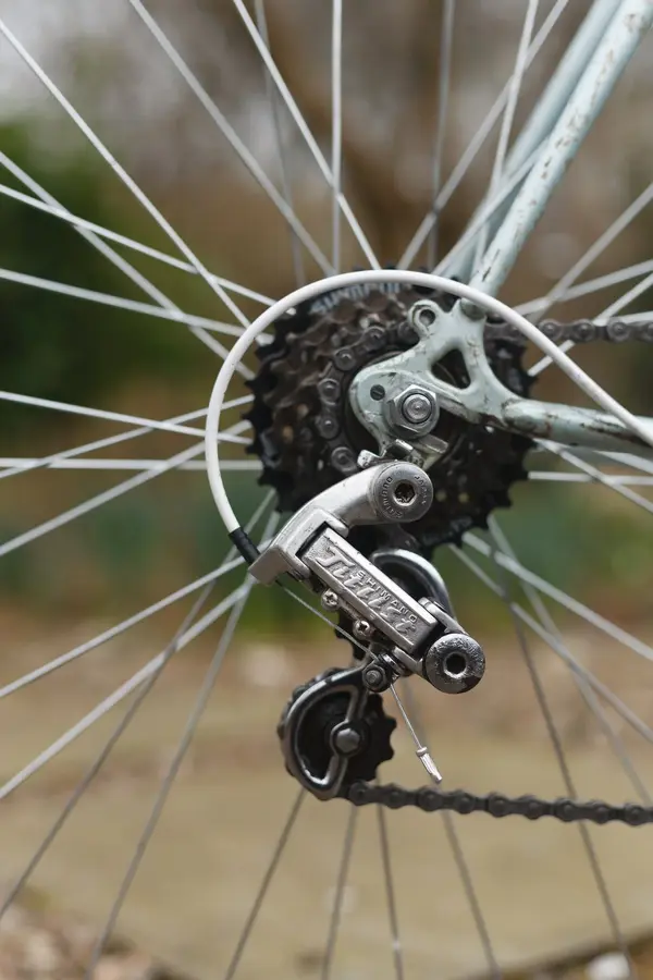

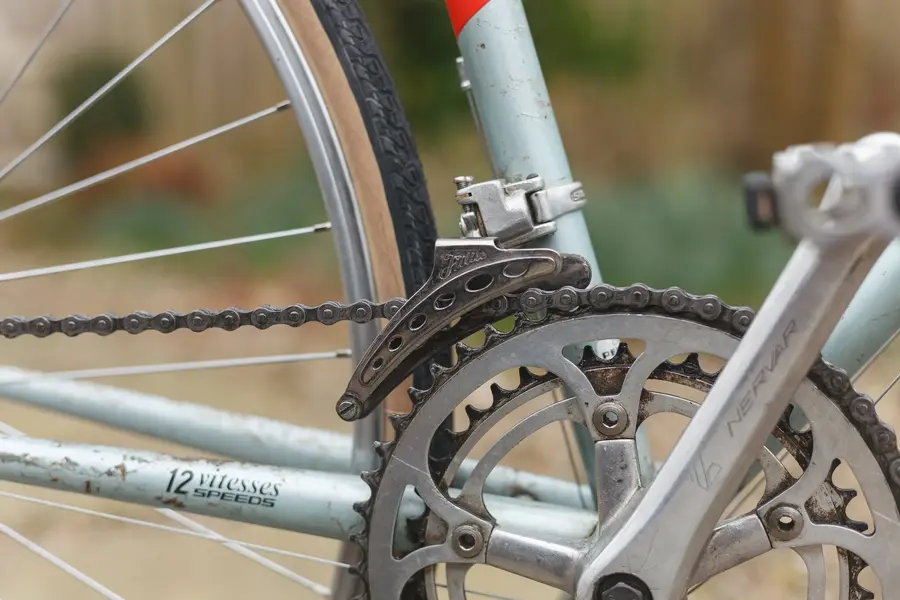

I kept the Shimano Titlist RD, and the limit screws on the original front derailleur were so worn it was simplest to replace the whole thing with a matching Shimano one.

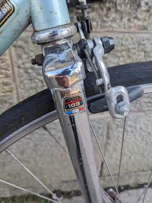

After some time trying to get decent performance out of the original brakes I decided a modern replacement was a worthwhile investment. I picked up a pair of Tektro R539 calipers, one of which I promptly destroyed trying to fit a Jtek bolt so I wouldn't have to drill the forks. I bought another set and just drilled the forks, using the leftover front caliper from the first set on the rear. Lesson learned!
I also discovered that the frame will take 32mm tyres, although you need to inflate the rear one after putting the wheel into the dropouts!
I finally got the bike back together and gave it a proper test ride on my commute which I usually do on my Langster single speed.
First impressions were not great. The short stem and long reach to the hoods made the steering feel extremely twitchy. Coupled with having to reach down to shift it felt both unstable, unpredictable and sluggish compared to my usual ride.
I continued to commute on my single speed whilst I considered my options.

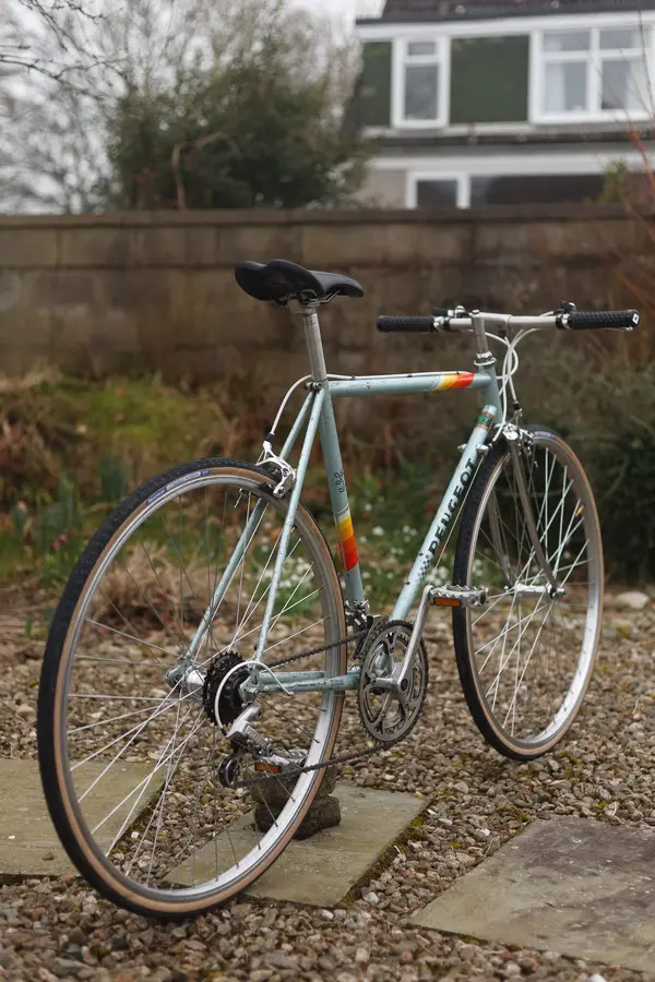

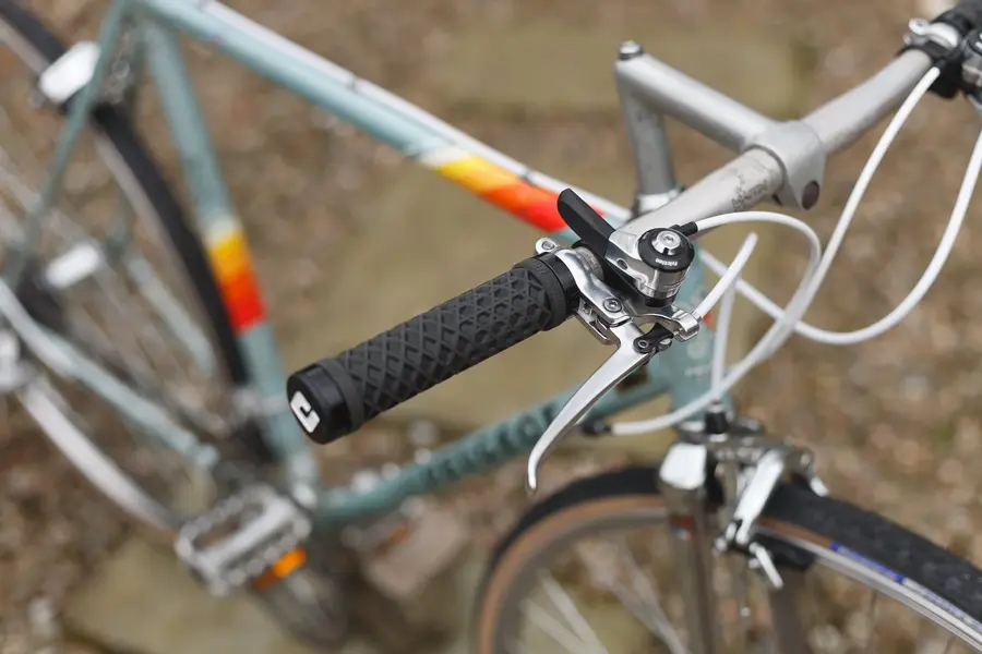

Unwilling to give up on the Pug completely I decided to try it out as a 90s MTB inspired hybrid. I found a longer stem and some scuffed Marin Lite MTB flat bars in the parts bin at my local community bike workshop, and bought some nice parts online to finish it off (having given up completely on the idea of this being a budget build).
These are the results. Definitely in need of a deep clean at some point, but I'm happy to embrace the mix of shiny and not so shiny parts. Not one for the purists but it's great fun to ride around town!
Plenty of patina!
