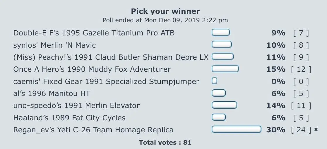

Seriously chuffed! Really grateful for all the support and votes.

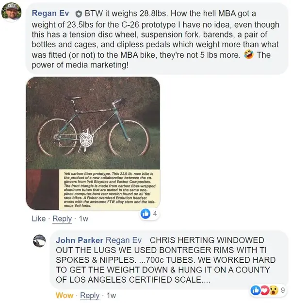

I have further plans for this C-26 which I'm going to partially strip after Christmas and swap out almost all of it in an attempt to get it close to the 23.5lb weight stated by MBA mag in their article on the C-26 prototype. I joked that they must've used journalistic licence on that weight claim, but JP retorted that 23.5lb was accurate and they (YETI) measured it on a calibrated Los Angeles country scale.
With that said, and if my interpretation of the BOTM rules is right, I should be able to enter it in BOTM again, with a possibly of it winning BOTM twice. 8) I'll swap the forks, stem, bars, chainset, wheels and, if I can find some, tires. Here comes C-26 v2.0 8)

I don't have an itemised list but I could probably get it. Martin at Second Spin Cycles is planning a full replica build of the prototype C-26, so I won't be attempting that, just seeing if I can put mine on a diet, for the fun of it. (I'll probably restore it to the spec here if I take it to Mayhem though.)
I think the C-26 proto used a Campy drivetrain (not impossible to find but I don't like it and don't see the point but I can look up the weights for comparison)
with Shimano M730 cantis (I have)
Bullseye cranks (I have, not sure what rings, maybe Campy, maybe Sugino)
Bullseye hubs, not sure what cassette (I have a Bully front, probably keep Shimano rear)
Bontrager rims (I presume MA40 rolled by Keith but not sure, and not bothered, because finding a set of those will be tough so I'll probably go with Araya RM20 which are light enough and period correct)
Ti spokes (hmm, doubt I'll find those so will search for the lightest SS)
Yeti fork (I have)
HyperLITE bars [unbranded/labelled as EASTON] (I have)
FTW alloy clamp-on stem (I have an FTW steel quill - close, but no cigar :lol:)
Specialized Ground Control tires with lightweight 700C tubes (interesting choice on tubes but I'll never find those tires so I'll need to see what else I can locate)
Unknown BB (maybe a Phil Wood?)
CK headset (I have one)
Turbo saddle (yes!)
IRD seatpost I think? Not sure. Needs some investigating or simply source a suitable alternative to the porky XT one installed now.
So it'll make for another interesting build I'm sure. And I think it could be re-entered into a future BOTM for the reason you highlighted. (I'm sure that I read about it somewhere on this forum before, when someone's bike was pipped by a vote in BOTM and someone (maybe a mod ?) said a different build would make it eligible to re-enter). If not, it's really no big deal, and I'd hate to deny someone else the chance to get the coveted title so maybe I won't proceed with that idea now I'm thinking more as I type this!
I've also been asked to feature the bike in a YouTube video by Joe's Bikes, which requires a strip down, so maybe that's the perfect excuse to swap stuff out. I'm also going to take it for a spin soon, it's a garage queen but not NOS, so I'm not bothered by getting it dirty or wet. Watch this space...
