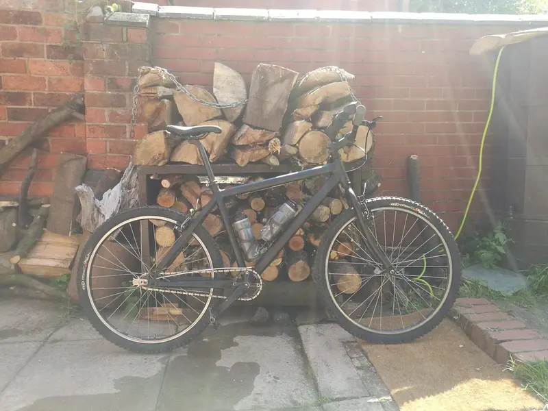

I have a Dawes Edge One single speed MTB in good condition carbon seat post & bars with 26x1.95 CST MTB Tyres @ 10.6 kg rider 14 stone.
In general & because of 23 mm thread hub bolts not ' spindles' & gauging my riding style to steel forks & AFAIK double walled but basic original rims wanted to ask is this 17.5 size bike up to relatively high speed XC riding mostly woods Inc a few downhill sections with air but not jumps nor intend to, just only smoothish riding no attempts at trial type riding etc.
Should there be specific caution I intend to administer or is bike not upto to mild to medium XC being old & carrying weight including sometimes 3 kg rucksack hydration.
Whilst I know ' stuff' better to ask here of those who have far more insight into thread title, in that answers may mean getting another bike keeping the dawes for winter hack general dogs body bike.
Pic is bike from internet but not my actual bike.

Here's the actual bike, I've measured the middle of the handlebar to the middle of the cushion of the seat & it's about 3 inches taller than the bars with the intention of purchasing the 110 & 20 degree stem to the current 90 that is set about right, the seat I intend to move back 10 mm to take adv of the rose flex seat post.
Anything from an inch equilibrium to level would be fine.
Are my calculations about right as I don't send sub £50 items back to the shop.

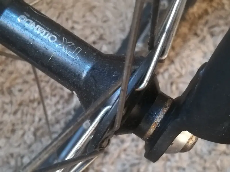

Wheel hubs appear to be 135 & 105 suspect 110 the new bolts req can't find from months of ad hok looking & there regeon of £30!
New regular wheels can be had for £59 on bankrupt bike parts but 1.75 isn't an upgrade, apparently 1.9 are around somewhere which would be good for 2.10 tyres prefer wider but seams a lost cause, my thoughts are that there's people on here that are experts on 26 wheels but perhaps dedicated single speed 26 are the preferable rocking horse S & thus this would invoke selling after this summer blasts as must gain some use after upgrading Inc LBS work as I'm not mechanically minded I break cranks ect (

I wouldn't worry about strength at all. I ride my Edge with panniers, rack and camping gear.

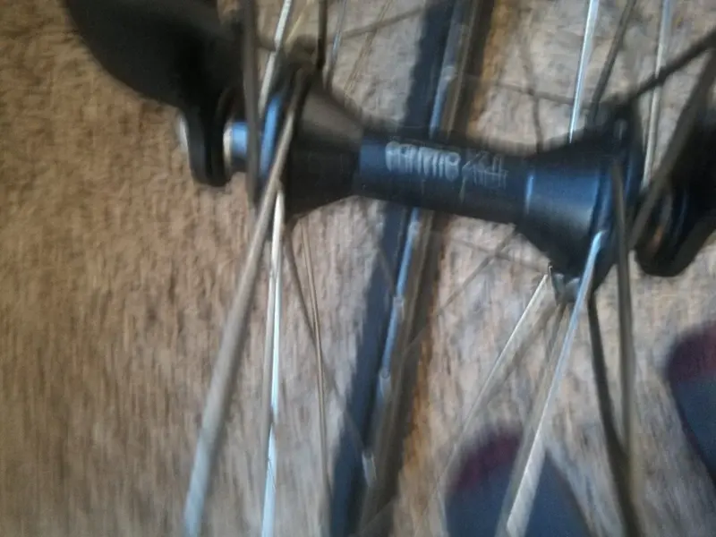

As for wheels, plenty are still available, you need a 135 rear and normal 100 front. Rims can be had from Spa Cycles, have a look at Sputniks, which are bombproof rims used by the touring community. 1.9 is AWFULLY wide for a rim, typically they are 17-22mm inside (bead-bead). The old 1.75 are cheap sections without the box structure.
Nice mash up!
Is yours a single speed?
Want internal rim size 19 mm minium preferable 23 & 20 would be good, you think 19 mm wide as I assumed 1.9 rims refers to 19 mm wide internal & 1.75 internal 17.5 mm.

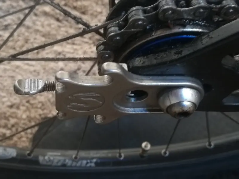

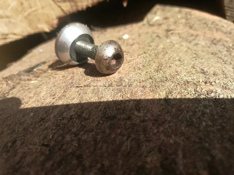

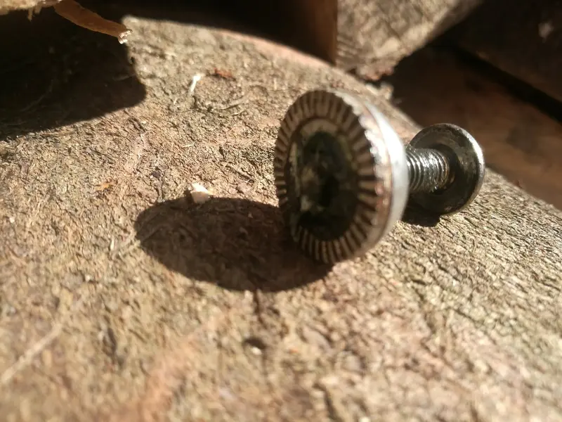

Yours appears to have spindles mine has thread size 23 mm bolts that don't inspire confidence are old & can't find them for want of trying, bike can take 25 mm bolts but the cup washers serrated or not I can't find nor the bolts with 18 mm est dome heads.
