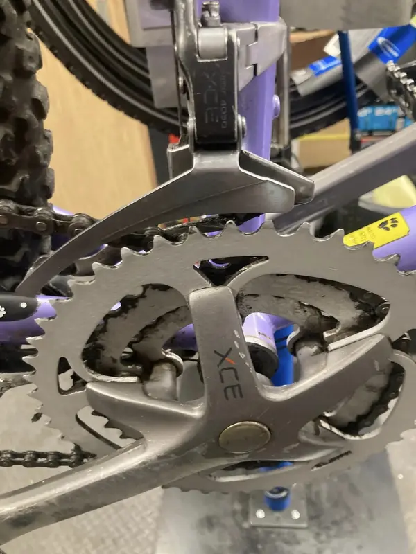

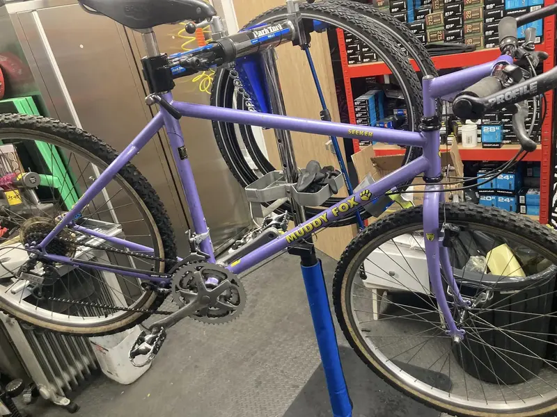

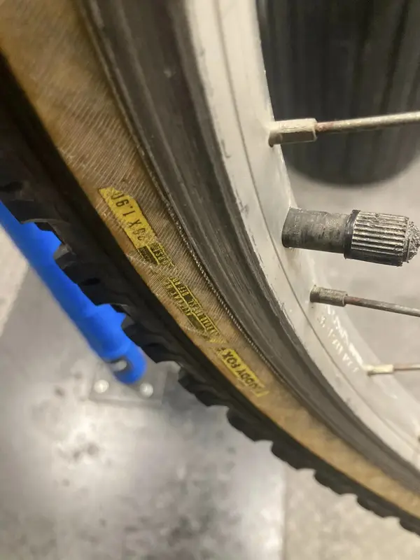

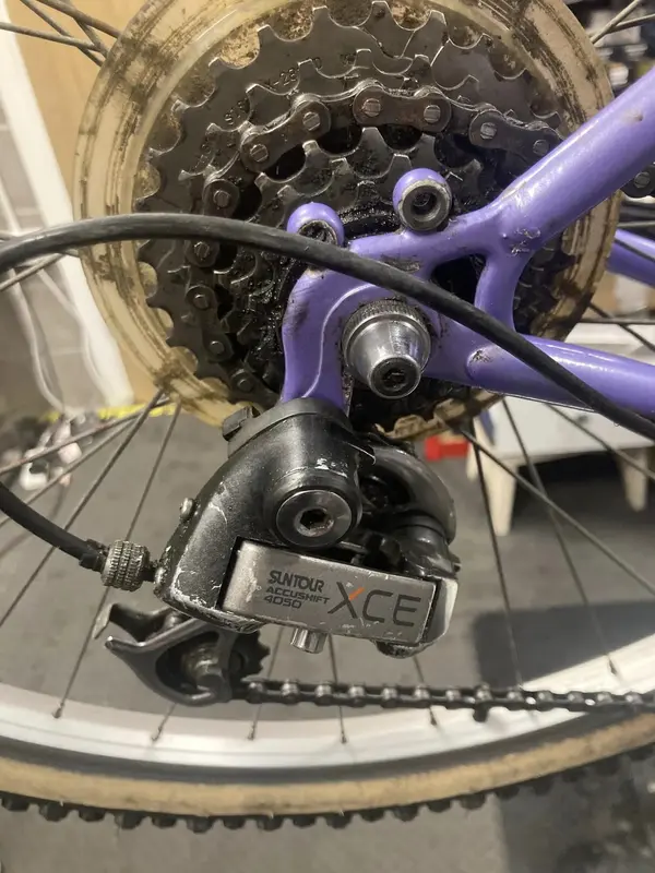

so what's wrong with it?

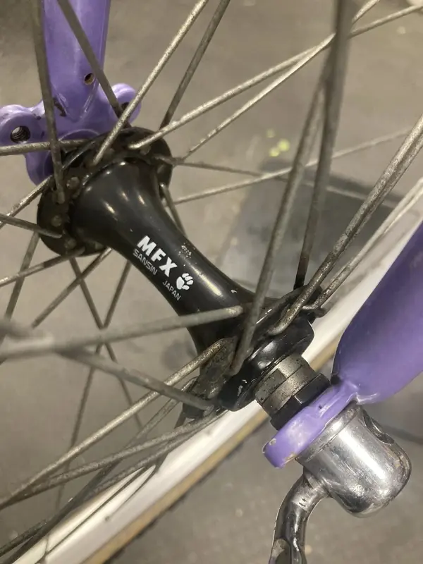

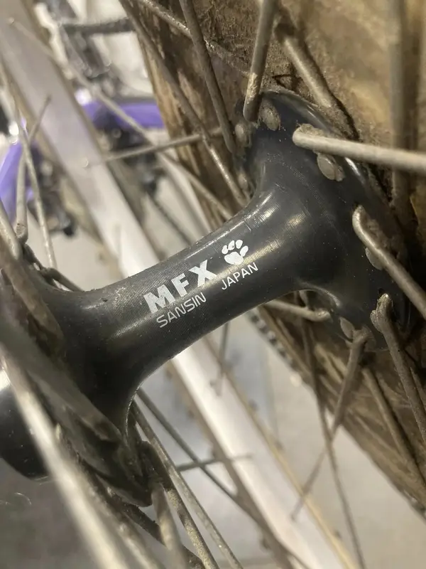

BB is rough, rear hub is loose, gears feel heavy due to sticky cables, brakes need pads and cables, spokes are rusty, tyres are dead, paint is in typical survivor condition.
what am i going to do with it?
i kind of want to go full restoration, frame wise i could just clean the hell out of it, but i think i'll have it refinished, original. i want to use as much of the original parts as possible, so i think i'll rebuild the hubs, re-spoke the wheels, i may put some nicer mavic rims i have on though, more to get a machined rim service to improve the brakes though, i intend to keep the gearset, worst case fit a new freewheel (yes freewheel not cassette) and chain, the rings i think will be ok, i also have a pair of panaracer dart/smokes i can fit.

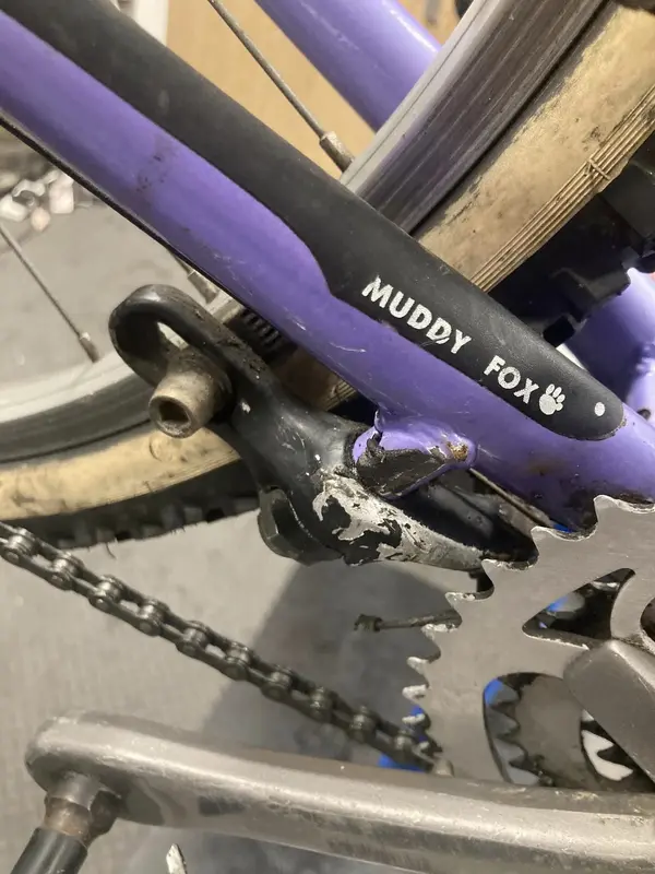

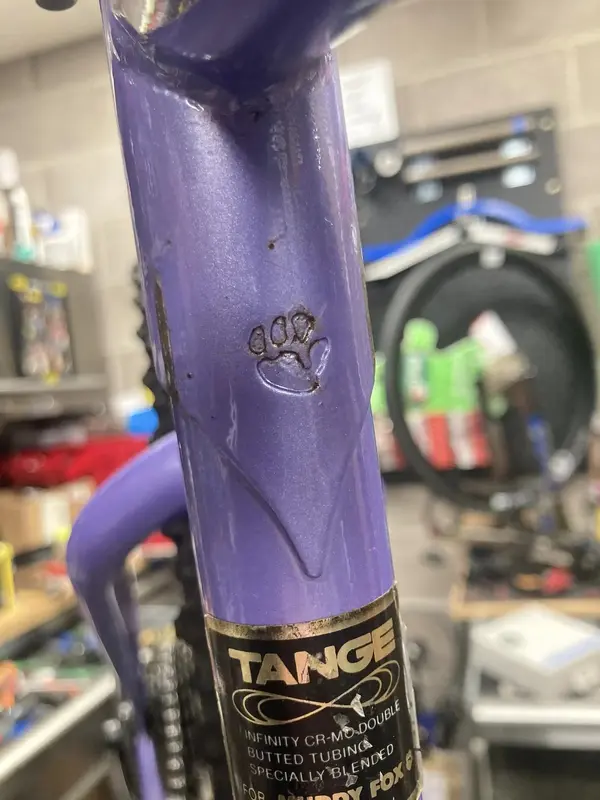

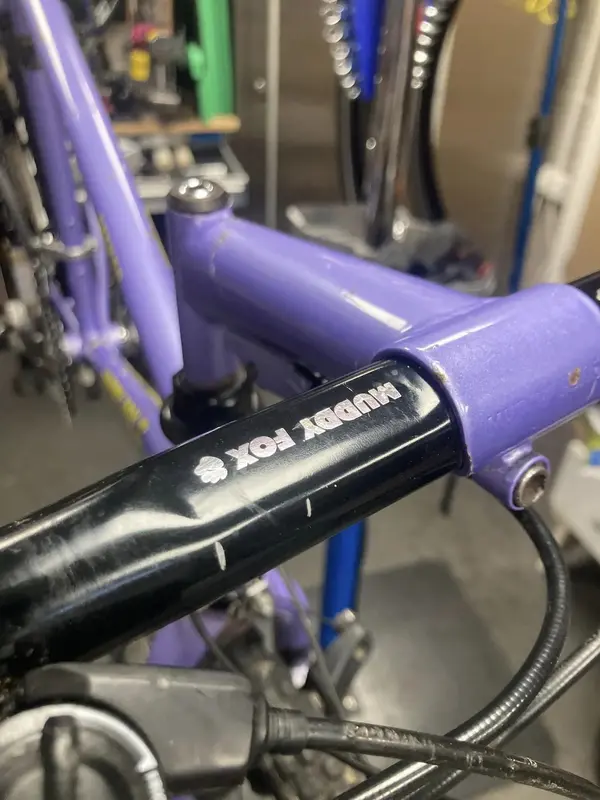

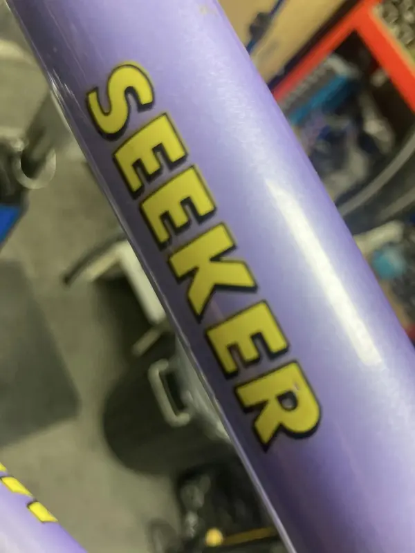

the only other thing i have noticed that is a little weird is when i got there to collect it i noticed it had a rear U brake, something i didn't remember mine having, so digging in to the catalogues here i found the 1989 catalogue, sure enough the Seeker is in there, shown with cantilever brakes front and rear, so i checked the 1988 catalogue, alot of those bikes had rear U brakes, so i think i have a very early 1989 model, a half year kodel maybe? whatever, i don't mind either way.
anyway here's some pics so you can see where it started

Pretty much original (apart from saddle & bar-ends?) + awesome colour + Suntour + U brake = UBER COOL! :cool: 😍
