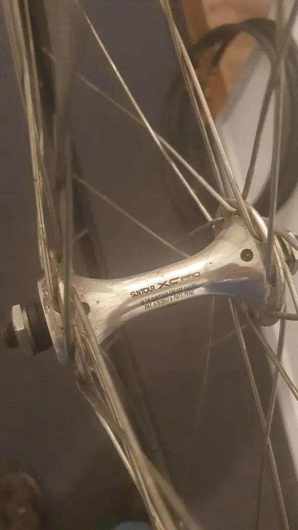

I have a lead on a period front wheel with xc pro hub. Pickup this saturday. Stay tuned.

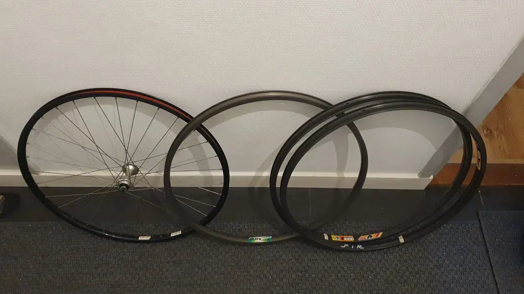

found a wheel with a suntour xc pro front hub. Rim is new specialized bxl21. Of course i bought some other rims. I couldnt resist really. An new arrya rm-20 32hole and a new set of 36 hole fir impes 192...

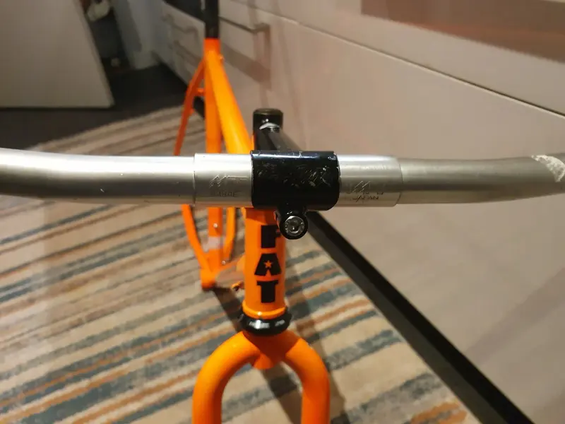

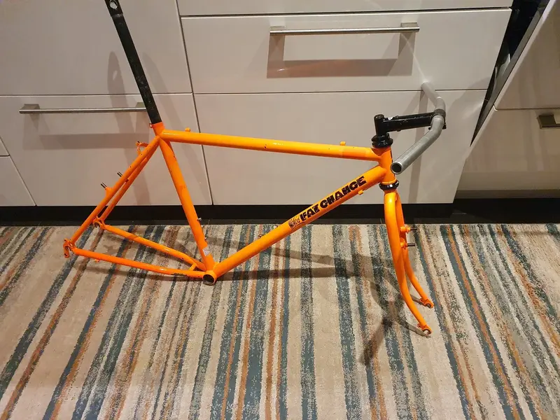

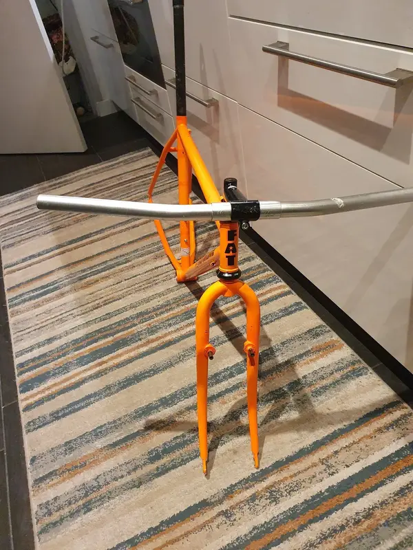

The current status. Test fitted some mt sakae handlebars with sweep. I stumbled upon these bars today in the local thrift store. Buried between mostly true junk city bike parts. 5 euro was a no brainer. Its in decent shape. Picked up a more modern ritchey flat bar as well for another 5.
This is a for me unknown chromoly stem. In decent enough shape and it came with the bike. Needle bearing headset put back in with plenty of fresh grease.

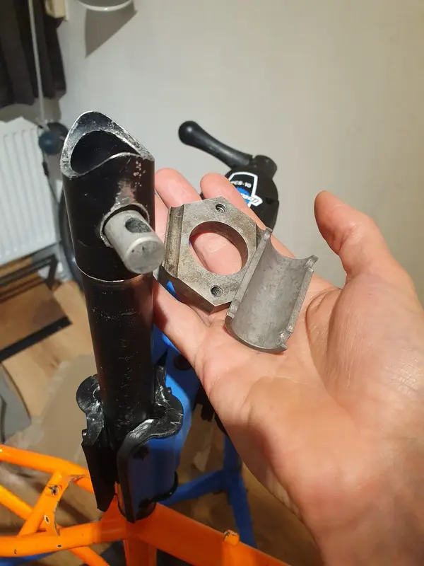

This seatpost came with the bike as well, but its a bit damaged from the forcefull removal in my vice. Now its a placeholder for in my workstand.
I put a bolt through the pin hole to bolt some wooden blocks to it to be able to clamp it down. The alloy being of course softer than the steel bolt has stretched the hole quite a bit. Bit of a shame since it is a syncros post... i can try and polish it back up. But i have no idea how safe that post still is. Also both bolts were seized in the cradle and snapped. Those i managed to remove.

I have found some parts in unexpected places at great prices lately. The bar sweep definitely works for your wrists. It is 580 width across, reasonable size, I don't think it was ever cut, edge looks original. The bars that came with the bike were cut down to 460 or something.

You could possibly shim that seat clamp but I would drop coin and buy a Repro from Synlos ( much better made ) or TCs one. The original IRD seat clamps/alloys are very soft and squeek like Fxxk. Love the sweep of the bar and its period correct. Never been a fan of RM20 rims as i used to burn through the braking surface in 6months of London commuting and one nearly got me when it split. Mavic rims all day. These Wicked are legendary for their lovely ride. Enjoy.
