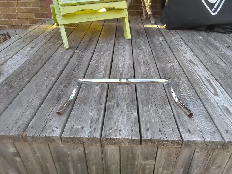

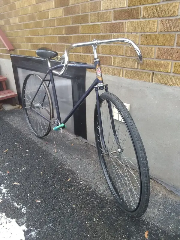

Boring, standard stuff, too narrow, too deep, so I clamped them in the vice and made a few tweaks here and there IMG_20221022_170907339.jpg IMG_20221118_134118852.jpg
Haven't had a chance yet to try them out. It's a coaster brake, so no worries about the hoods
