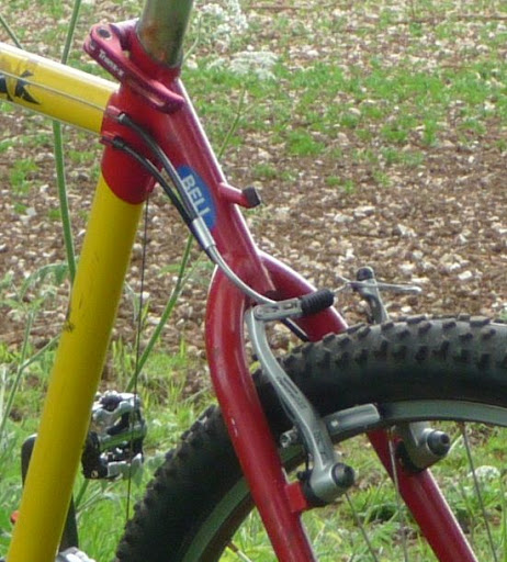

90 degree rear, would show the front but it has a 90 degree on it as well as it's all I had, lol
not brilliant as it's causing a dip in the horizontal pull part. but best I could do for a first attempt. I think a 110 make relieve that dip.. or some slight bending of my 90 degree.
