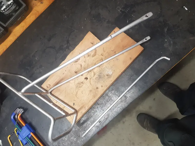

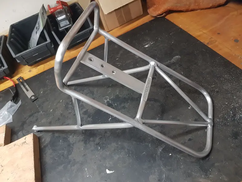

Decided i needed a bit of carrying capacity.....not much, just a bit.
So ive built myself a new front rack out of an old one!
Took an old blackburn rack that had been bent up at some point made for drop out fixing.
Cut of the front braces, heated and bent the remaining stays to the right angle and shortened them for a fork mounting position.
With the cut off bits made 2 new braces for the rear and some extra top support to stop my coat/ bag hitting the tyre.
Made some simple round bar eyes to fix it to the forks.
Simples....

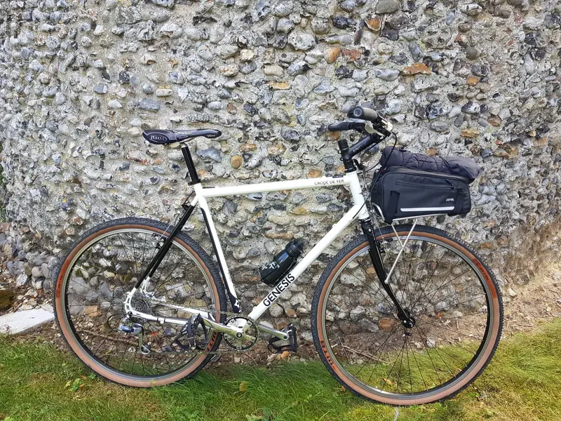

Its been a month. Been out for lots of rides...short and long. Including a couple of 50 mile + jobbies. The picture below is the bike where i started after the last few posts...but stuff has had to change.
1st was the saddle....fine short trips...longer not. Now using a specialized sonoma.

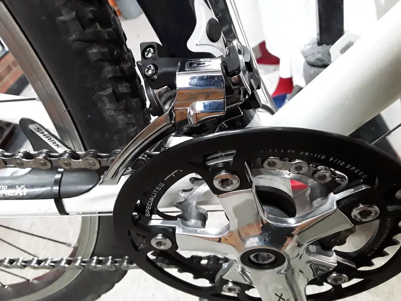

2nd i didn't like the empty outer chainring mount..it looked untidy..unfinished...so ive fitted a n aluminium chain guard. Neat solution.
3rd gearing....it was always going to be a fly in the ointment. The basic issue is the gaps on a reasonable spread 9 speed cassette are just too large to be confortable. Plus, the bail out is a bit feeble after a long day...or I am!
Im not going 10 speed which would iron out the issues as i then cant use the xt mech as its not compatible in terms of pull or max capacity and i really want to hang onto it. Plus i would need new shifters and chain too.

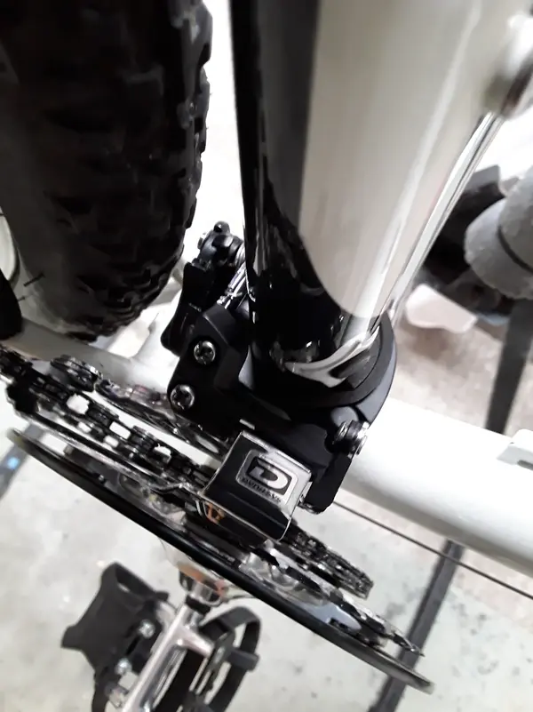

So i started looking at adding a bail out 24t inner ring. Problem is without the outer ring, none of the derailleurs i have fit...not that any fitted due to the tyre clearance and hitting the chainstay anyway!
The answer ive come up with is to add a xt m785 front mech made for 2x setup. These are designed for smaller outer rings of "modern" mtbs. Brill. Problem was when fitted it still hit the tyre. Solution is to use an eccentric mount rubber...or im my case several bits. It works really well.
At present I've added a 9 speed xt shifter to match the rear, but im thinking of possibly going back to thumbies and 8 speed 11-28. Which would be far more retro.
Although 9speed 12-27 gives a lovely even and tight range and the 24 inner supplies a great bailout.
