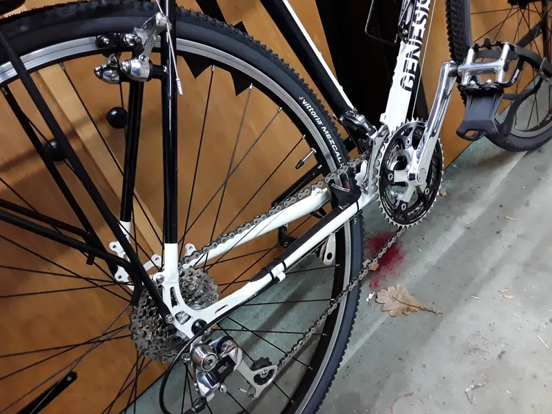

However, after the last few...failed....attempts to sort some gearing, I've made a massive retrograde step....one I'm very happy with.
The bigger ratio dinner plate cassettes are not for me, the jumps are too big....sorry im not a down hill racer and I like to enjoy my riding, not feel like im either in a spin class or grinding far to high a gear.
The 12 28 9 speed cassette i built is fab, in fact i might swap my tourer over to similar if i can find more new 12 27s to convert.
However, this means you need a small bail out ring....see last incarnation.

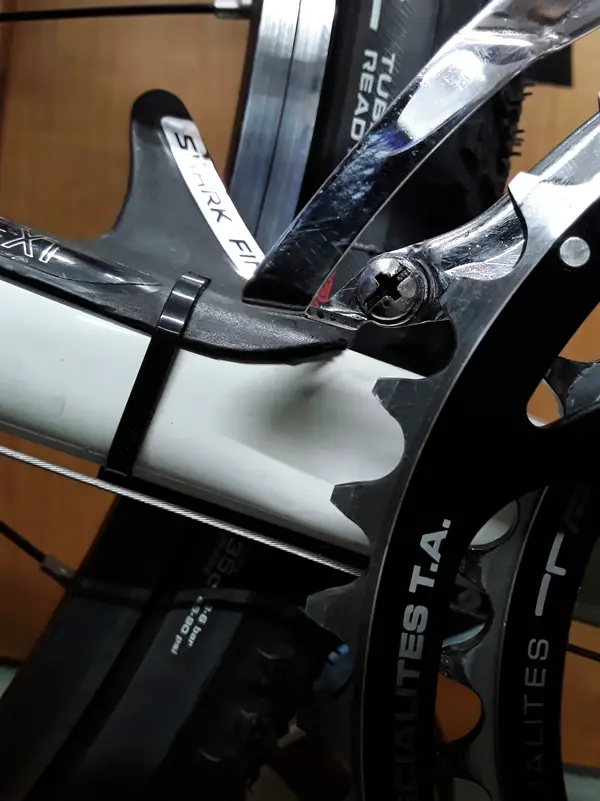

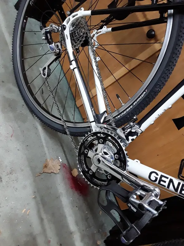

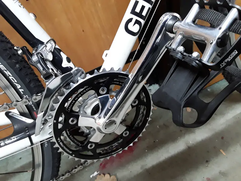

But, i realised i was getting away from the retro concept and really hated the modern 2x xt front mech. Sadly an old xt m735 wouldn't work as it hit the chainstay / tyre.

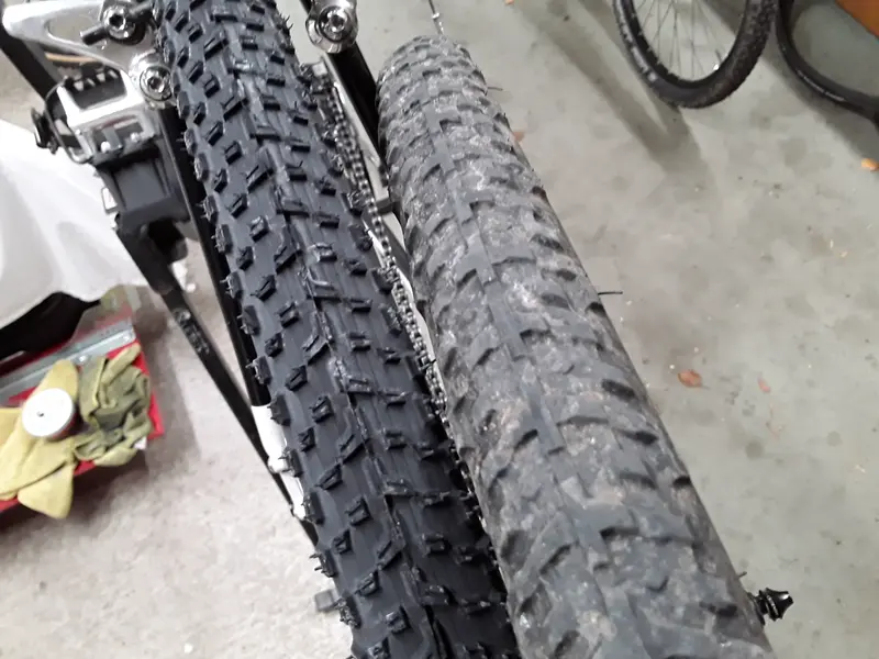

Then I can across the 35c vittoria mezcals. I use the 26 x 2.1 on my marin...they are fantastic. 200g lighter, and give derailleur room. Just a shade narrower than the suposed 40mm nanos.....which aren't btw.
So , it then became a no brainer to add the retro mech. So to avoid the chainstay.....yes you guessed it. Im adding a third ring! 😂. 44t just moves the mech to the right spot. High enough to clear the chainstay and low enough to clear the tyre.....
Winner winner chicken dinner.....

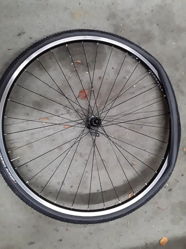

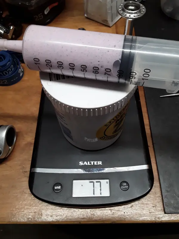

Ive also slimed the tubes....ive swapped to 99g lightweight tubes, over the 160g continentals, the slime weighs 78g so its about equal.
The mezcal are 200g lighter than the nanos, but as with all modern tubeless ready tyres, the cases are thin (i assume the sealant stops the issue of punctures when tubeless) so im happy to get a bit of protection from thorns too.
Again like a lot of tubeless tyres these are tight! Considering these old rims are loose as a......well you choose a simile....and that most tyres ive ever used on them over the last 20 years fall on and off....these are tight.
God knows how you get them onto a tight tubeless rim like the r460s i had recently😂.

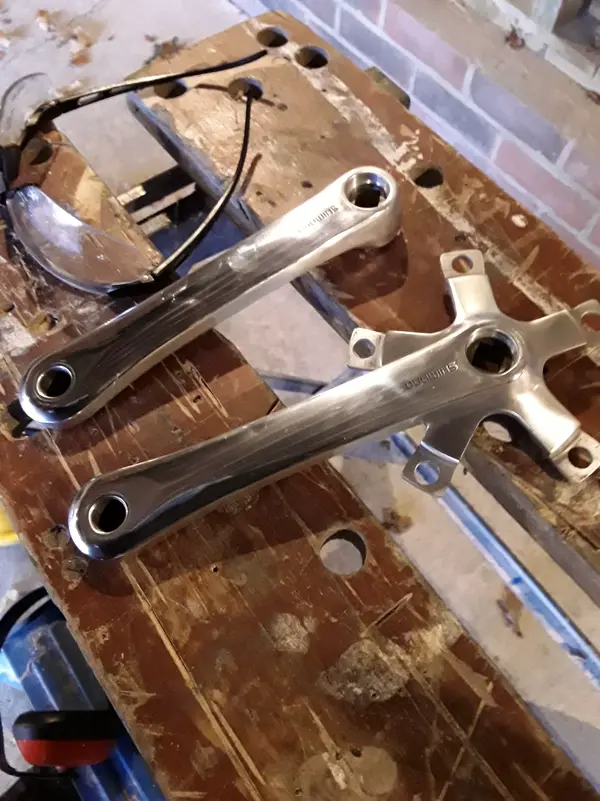

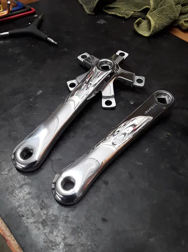

Finally ive decided to go full retro and xt...as far as possible. So, ive ditched the xtr chainset and used an old m730 that came to me completely foobar'ed.
So out with the polishing kit...and grinder to start with...😖. Stupidly i forgot to get a start photo...so the first is after cutting all the damage out ready for polishing.
But 3 hours later im happy....all back together.
Now just need a bit better weather to get out and enjoy it more.
