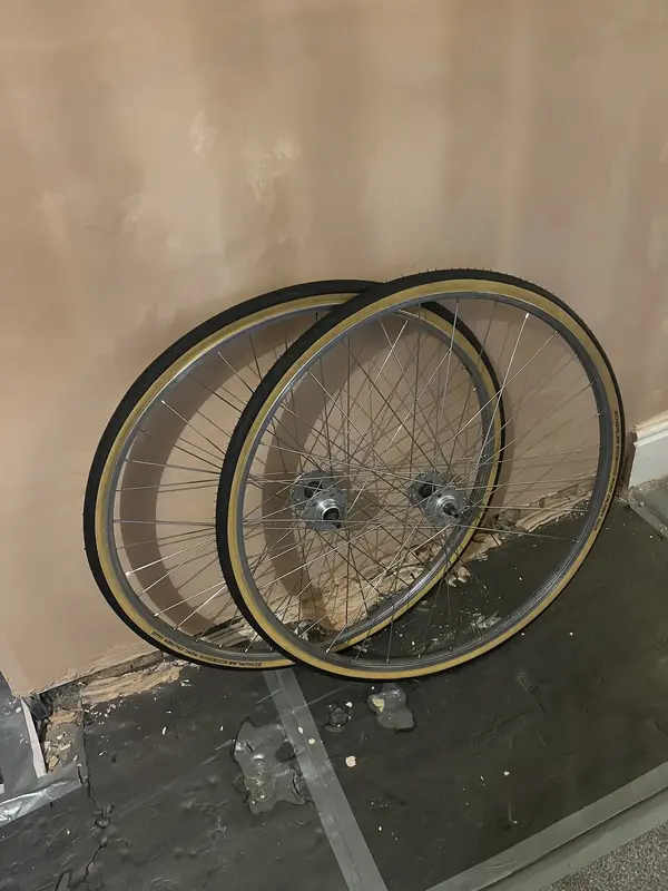

In other news, wheels are built, will pop them round to the LBS just to check and fix one I simply cannot get to true :(

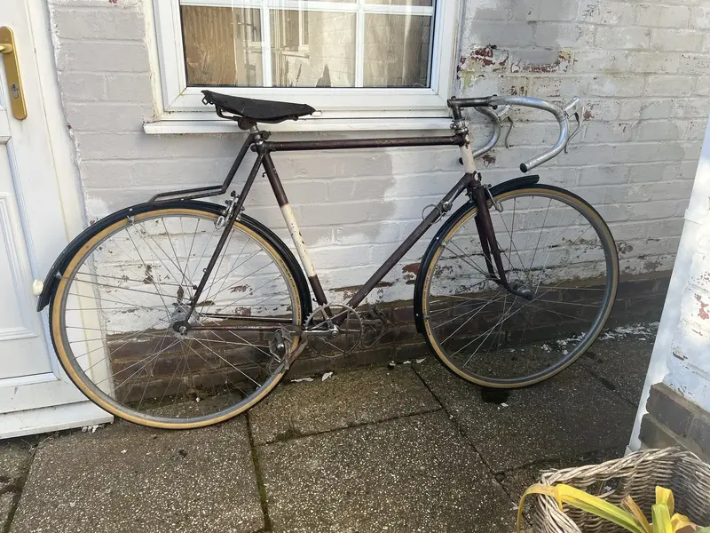

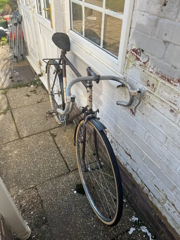

Well it’s been a while, but progress…
First thing, the 5 speed block doesn’t fit. I noticed when the wheel came out it the frame when ‘springggg’ and having tried, it’s definitely a no.
So, not sure what to do now. Would a three speed work? The clearance is vey narrow to the chainstay, will try and measure it in a bit.
However, everything else is coming along splendidly and if I’d been a bit more organised I could have been pottering about on a sunny test ride, but there we are. More news hopefully soon…

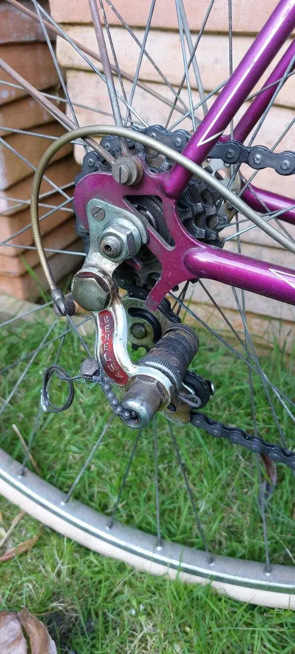

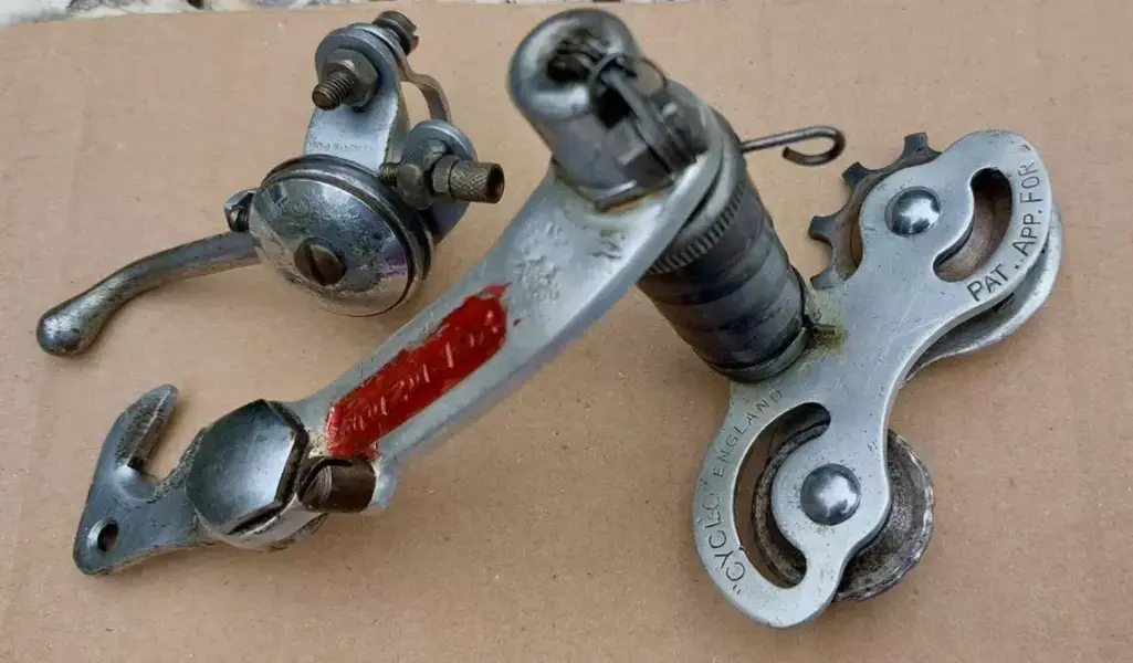

also, how the hell do I fit the Benelux mech? The big spring means it’s right into the wheel and - short of fitting and cabling it so as I can pull it in, I cannot fathom how to manage this.

This article may help https://www.classiclightweights.co.uk/restoration/adjusting-benelux-gears/
Do you know the model name of the derailleur? The model name might assist in finding fitting instructions on line
I spent the best part of yesterday trying to get the flaming Benelux mech working. Actually, not even working, just fitted.
What a Gordian Knot of impossible complexity and idiosyncratic nonsense.
Just gave in the end, didn’t want to damage the spokes or risk smashing everything up in a fury.
Hence putting out the ask for a Gran Sport instead. I know :(
There’s now a really lovely 3speed block in (thanks Tom!) with proper clearance and a 28t big cog - which with the 46 front means I might just about get up the first hill).
But the brakes are cabled and seem to work well. Really nice metal coil outers from Velo Duo, will take some pictures later, was too dark at the end of yesterday.
Also decided to use a pair of CB levers instead of the Lee Chi ones, they look much better.
Also managed to get hold of a saddle (thanks Brane for the offer of the Mansfield) for £20 which should be fine. I hope.
In annoying news, I broke one of the rear mudguard stay tabs on the seat stay ffs.
