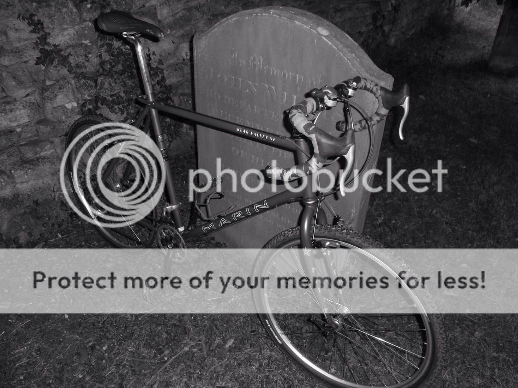

Yeah it's great- flies as fast as I am make it! Sadly it's pretty much a done deal that what you see on this frame is going over to my rc300. Not sure what will become of this frame/fork set...

I went almost full crosser on my pace, discs, ergos the lot.
Hardest part was getting a stem that worked (Ritchey adjustable on the 3rd try), I also had to give up on a Road front mech due to a combo of seat tube size and cable pull.
Thats why bar end shifters are pretty much the only way for a proper integration of what is a mongrel build.
Front mechs can be a bastard to index correctly due to the wider MTB frame, cable pull, cage size, reach etc etc.
They're a challenge or rubber walled room time.
:lol: I can agree with that.
Personally think STIs are worth struggling with - the construction quality today is extremely good and having
all the controls close, being able to shift on or off the saddle makes riding more fluid.
There is a good article here which is well worth a read to understand a bit more what Shimano have done
to make a closed shifting system. You have been warned; prepare suitable beverage in advance!
