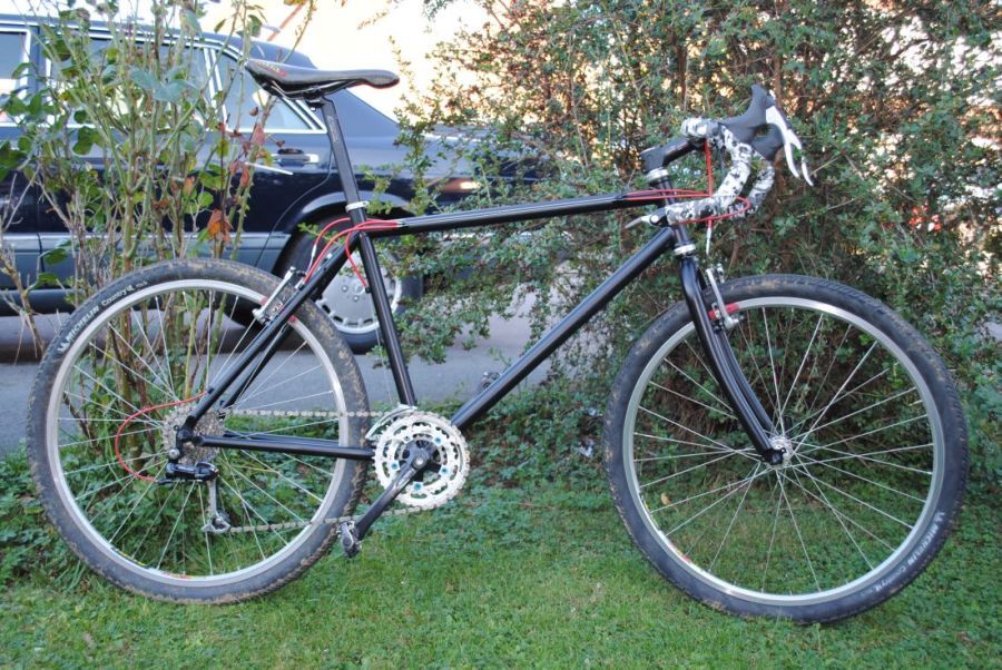

The trick with drops is to fit a higher rise stem than you would with flat bars so you can use the drops and the hoods without being too stretched out.
If you intend to ride dirt then you are better off with a dirt drop style bar which have flared ends. Loads of them around now from Salsa, On-One etc. The Alpkit ones are on sale right now. Most I'm finding now are 31.8mm, though I'm sure you could unearth some 25.4mm if you searched. But if you are going to fit a higher rise stem then just get a 31.8mm stem as well.
Tektro RL520 levers work with V brakes and MTB cable pull discs. You can run mini vs or cantis with normal drop levers. You can also get road cable disc calipers that will work with road levers including sti units.
You can use bar end shifters, but on dirt drops because of the flare they stick out a fair bit and are the first thing to get hit. You can get accessory bars that will fit MTB shifters from SJS. I'm using one for my alfine shiter on the bike below. Other options are Pauls mounts with bar ends or downtube shiters, or bodging things so the clamps fit. The other option is just run ss.

Thanks Barry for the pic and info, that's just what I wanted to know, cheers!
