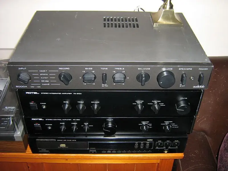

And on another subject, finished repairing a basket case of an Audiolab 8000A today. Looking like it had been dropped on its back panel at some time as I had to replace all the input sockets. Then found that the volume pot had come apart internally, meaning that right channel volume was no longer proportional to the position of the knob! THEN found several caps in the MM and MC pre-amps had gone high impedance leading to some pretty weird tonal shifts! Now all that's sorted, I must admit it's a pretty fine sounding bit of kit, with superb low end detail and power (compared to my Rotel pre / Quad 405 power combo. It's a little ratty looking, but I may hang onto it for a while. Might try it as a pre with the Quad...
The Rotel 810A underneath is freshly repaired and re-capped and is for sale. There's an 820BX and a NAD 3220PE coming soon too when I fix them!

On a roll tonight! That's the RA-820BX sorted too. Open circuit zobel resistor leading to low power on one channel and early clipping.
To run an older 8000a as a pre/power you need to move a couple of resistors (if you havent already). From the factory, the pre-outs were in operable. Never did find out why.
