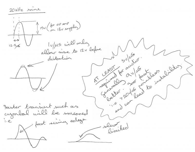

A very rough and dirty explanation of why Op-Amp slew rate matters - a lot - if accuracy is important to you.

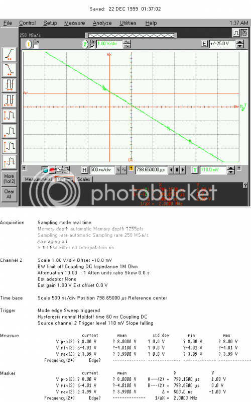

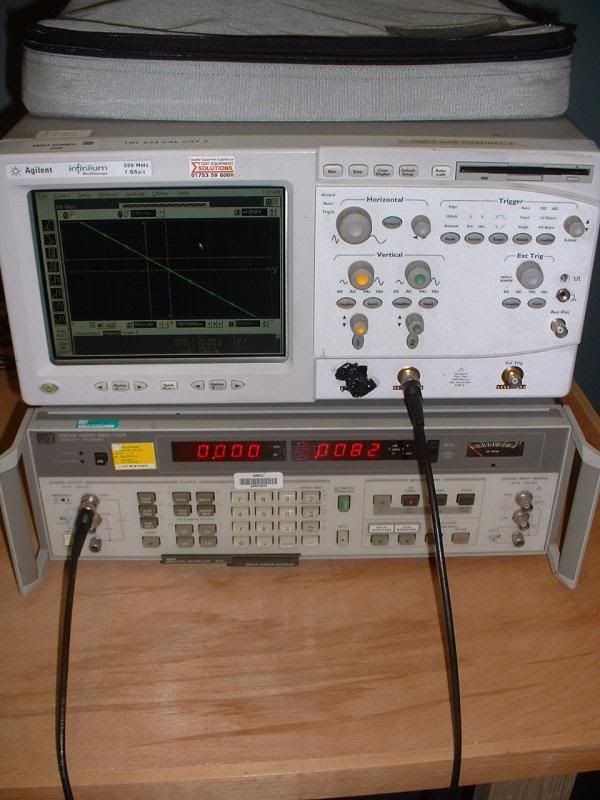

So to add measurement to the above, I took this...

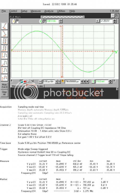

...and did this. This is a 20kHz sine wave. A not particularly tasking signal.
This is the overall picture, difficult to measure with accuracy, so zoomed in...
If you rear the measurements, it can be seen that on the steepest part of a sine wave, to reach 1V (the standard metric for measuring slew rate) it takes 0.5uS. If an op-amp requires 1uS to reach 1V, it cannot reproduce that waveform accurately, and will chase the slew rate as hard as it can producing a sort of triangle wave with a rouded off top.
Ergo, some op-amps are not suitable for audio, but will certainly sound different!

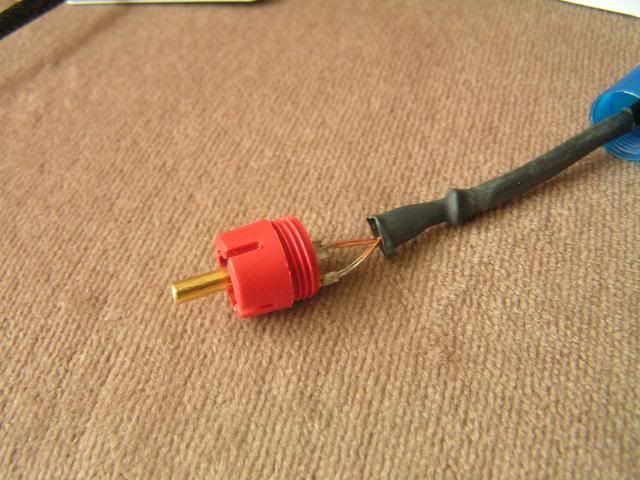

OH by the way i looked inside my silly special cables today, the ones that are meant to be cryogenically treated............there's 4 little braided wire , THAT'S IT.......then seperate to two in each pos and return, they seem to have no insulation just an outer covering 4 bare looking braided wires.........hows that work then, surely it should short ???..........if there is a coating it's nats thin :shock:
The pic does not show that you can see the wires through the sheeve stuff......thought pos and return can't touch ?
Yeah, that's a very naff cable - the insulation could be varnish (like transformer wire). Different for the sake of it. Bet the capacitance is sky high...
I prefer a screen rather than some bullsh*tty twisted pair which does precisely nothing to reduce noise in an unbalanced input.
