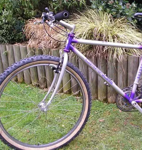

hi, here is my orange, which i really need the stem out of. the thing is, the bolt that goes down through it is rounded off where the allen key is inserted, and i need it out without any damage to the stem. can anyone help? cheers, sean
Have you tried to bash in a star bit (torx), but im guessing it may be a little hard for that.

its highly tightened . force probably wont get it out

The easiest way to get this out is to drill the head of the bolt until it snaps off.
Start off with a 6mm drill bit and go up in 0.5 - 1mm increments until it's done.
All you do is drill just a bit deeper than the bit where the allen key fits. If you go a bit at a time the bolt should eventually break and all you'll need to replace will be the bolt itself.
