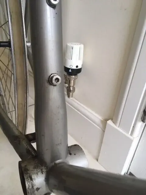

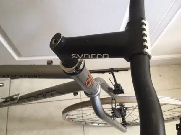

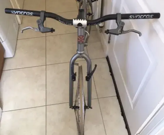

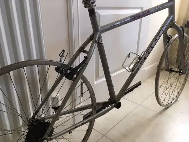

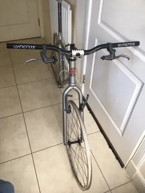

Was chatting to a mate not long ago who was clearing some stuff out.
“You love that old crap, you want my dads old bike?”, me “ maybe what is it?” “It’s a Kilauea, rough shape and incomplete but it’s yours for £50”
“deal”
So I go to pick it up sight pretty much unseen and I’m happy straight away, it’s a 19” - would have preferred smaller but it’ll be an XC whippet anyway

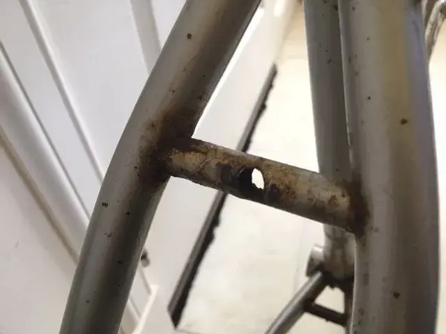

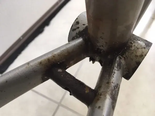

Bad points, Seat bridge and chainstay bridge are rusty, there is some crazing on the paint and it has a load of aftermarket stickers and it’s missing the seat lamps and dog link for the cantis

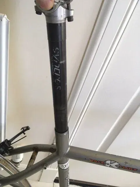

Good points, Syncros seatpost, Cattlehead (flip) and bars, XT wheels on 517 (cracked but I have a ton of 517’s in the garage) XT 737 with UN72 bb, Impact headset and XTR V brakes and Levers.
So I have a 737 rear mech and cassette sitting spare along with V brakes and a side from chain / cables / grips / front mech and the seatclamp I shouldn’t need to find very much else.
My first Kona and it should be a good un’

Sounds good, how you gonna run V-brakes without a cable stop at the rear though? Full length outer? Band on cable stop? Or some other trickery?

Now I have the very thing, found today in my toolbox, blue anno called “the backstop” which I bought for a C16R in 96 and then kept when I changed to Magura so one less issue...

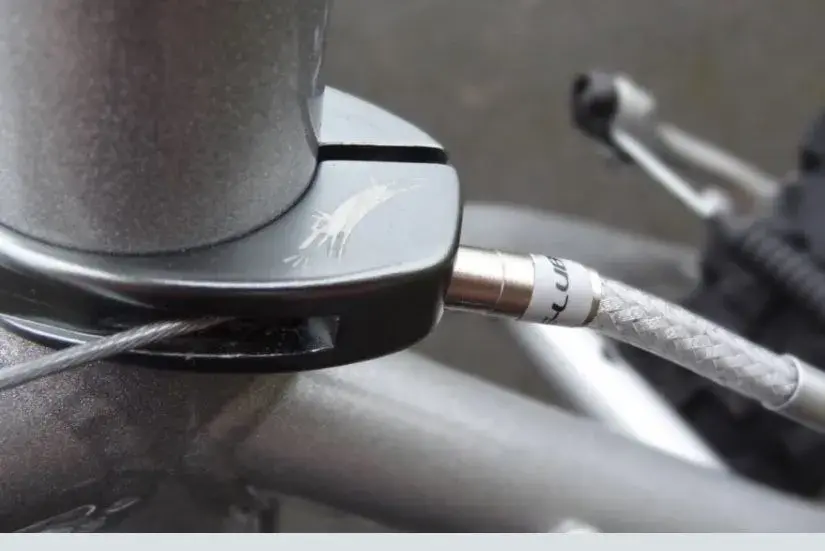

You can use a later Kona guide drilled out to fit v’s - have a look at my bike.

Any progress on this and what did you do about the rust?
Rob you could have posted a link instead of turning it into an epic quest
After tons of trawling pages I found this - on your completed build
Interesting idea - does it work okay as the brake arm has to move and the flex in that short run of cable can’t be a lot
