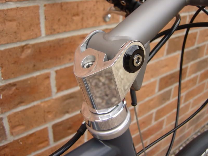

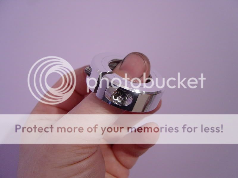

You could buy one of those lock nuts that have a bolt to cinch it down. That should keep it tight. There is no way to repair the threads if they are stripped. Are you sure the lock nut isn't what is stripped? The fork threads (unless it is alloy) should be harder than the locknut.
That's what I was thinking as the first / easy thing to try :
