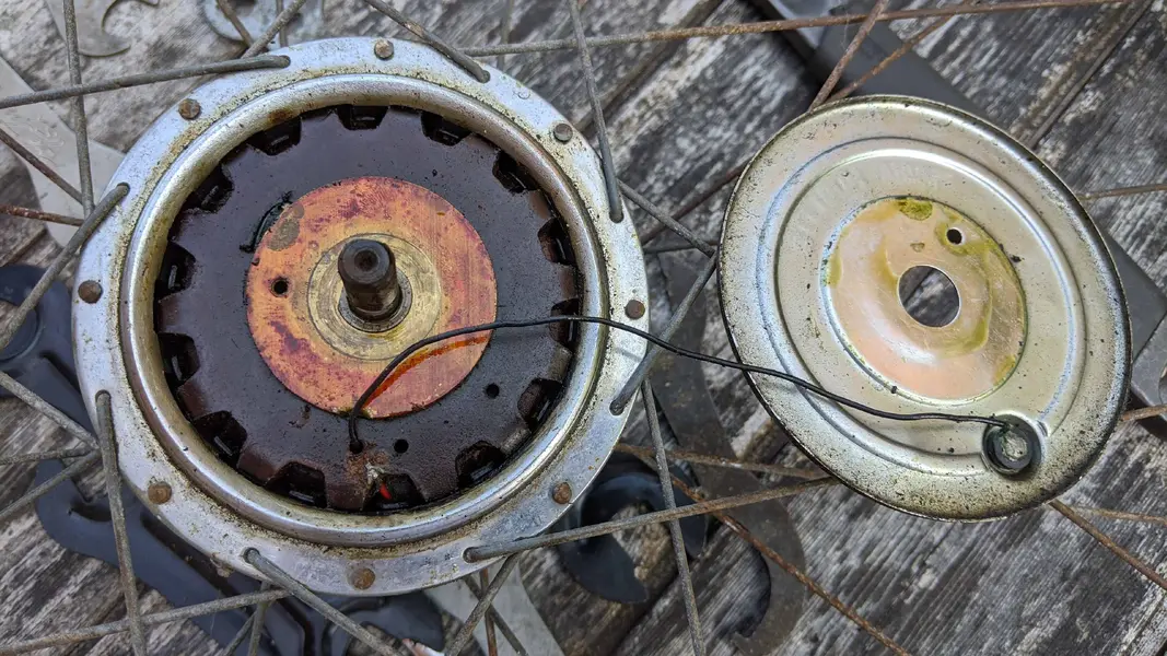

Here's what the BSA Hublite internals look like.

The dynamo still works and the wheel spins as well as can be expected. The wiring is shot so when I replace that, is it normal to run the wiring up the inside of the fork leg (the base has a hole in it) and out the crown? Currently it's tied to the fork leg and I think it looks a bit ugly.
You can see why I suggested hanging it from the front, but if your cleanup means removing the chain it is possible to feed it back in from the chainwheel cover, but again the bike needs to hang down from the front.

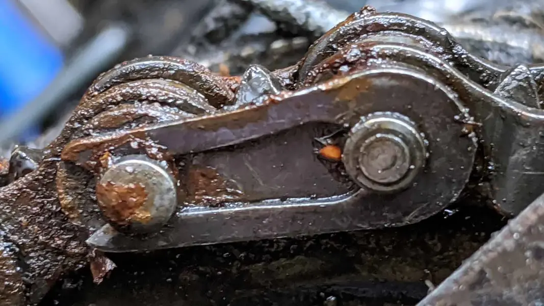

Is that a BSA half link I can see?
Connecting link probably has the usual spring clip. Pre war BSA had their own with a sort of swivel lock on the connecting link.

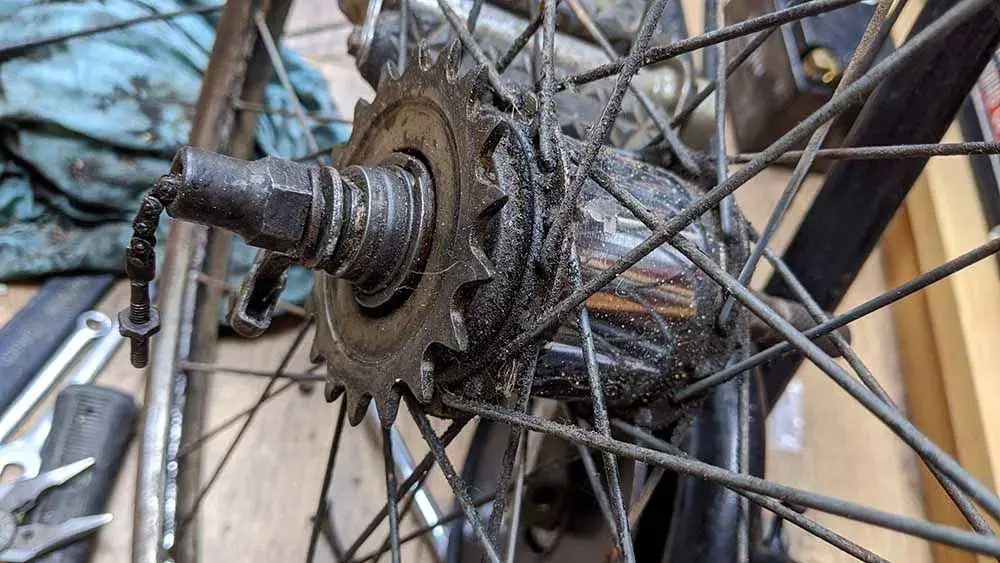

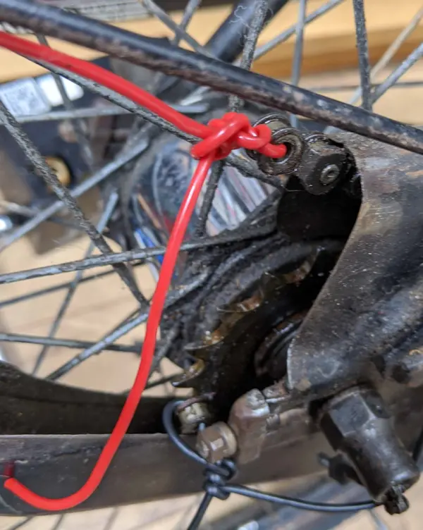

Yeah dead easy to get out. I was worried the chain would slip off the cog as soon as the links were removed but I was able to push both wires in to push the link out. The chain stayed where it was thankfully.

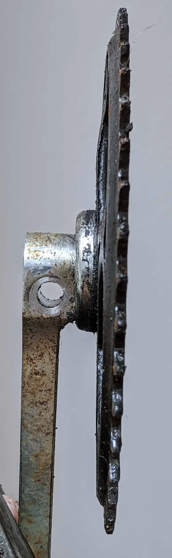

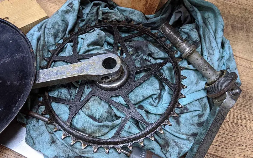

And I finally got the crank off. The non-drive side cotterpin is stuck fast, the nut just ploughed its way through the thread when I tried to hammer it out, so I think I'll take that to a mate of mine, who was a motor mechanic for 50 years.

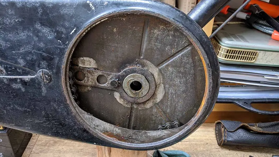

Interesting that the chaincase is bolted to the short chainstay, with a reinforcing piece of metal presumably bolting onto the dropout at the back. The spider isn't completely flat, it's a slightly odd shape which I've tried to picture but the chainring itself appears true. Odd hole in the centre. Perhaps the chainring is offset so it dips in and out of the oil?
And now I have to fish some of the ball bearings out the chainstay, where they've parked themselves :(
