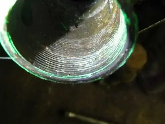

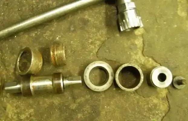

I was a bit neater, infact I was able to reuse the bottom bracket.
