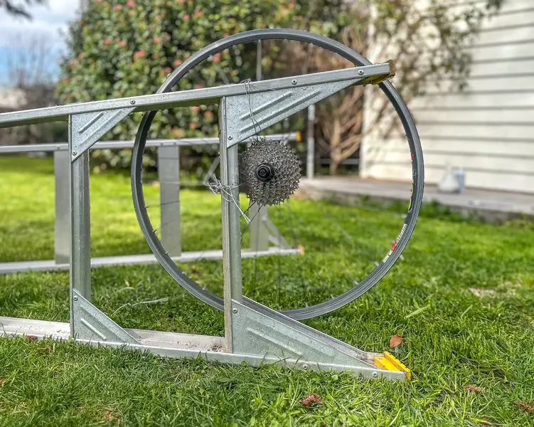

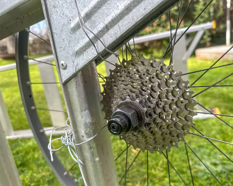

So I took to the interwebs to see what I could find, and turned up a rather gymcrack technique on Reddit that seemed worth a try. The idea is to isolate the cassette from the rest of the wheel by clamping it to a ladder lying on its side -- in effect, I guess, a super-long chainwhip that's also pretty solid. This is done by lashing the cassette only to the frame of the ladder which is lying on its side. Care should be taken not to involve any spokes in the lashing. The Reddit post recommended using old brake cables, of which I had plenty. The cassette (thankfully not M950) had convenient holes in it that suited this purpose. Tying knots in the cable was a bit of a challenge but I managed to get the cables (three of them) pretty tight using good old reef knots.

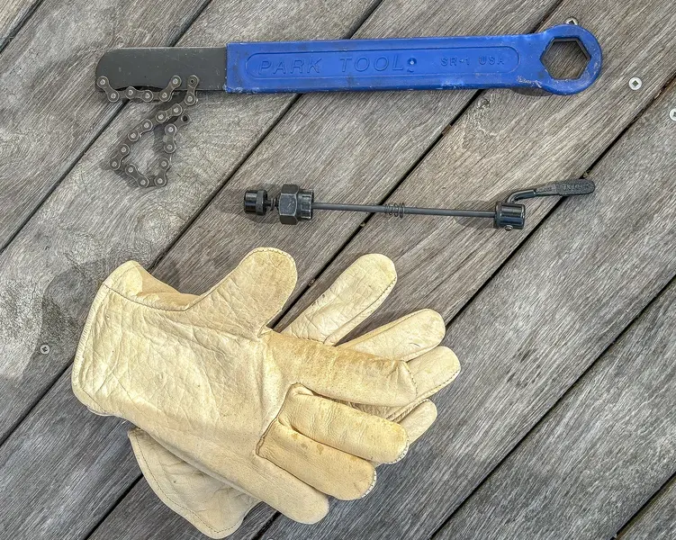

Then you lock the cassette removal tool in place with a QR skewer (I used a beefy one from a Tacx indoor trainer), place your spanner or similar implement over the removal tool, and add a breaker bar if you have one and if it's required. I also got a nice pair of work gloves to prevent further injury to various knuckles.
My first attempt failed -- one of the cables came undone when I started really pushing on the spanner (in my case, the other end of my chainwhip, which fit (fitted?) better than a shifting spanner). With some swearing and re-tying, everything seemed a bit tighter and I gave it another shot. Just as my vision started to blur and my face achieved an attractive purple hue, the ring finally moved and in minutes the cassette was free!

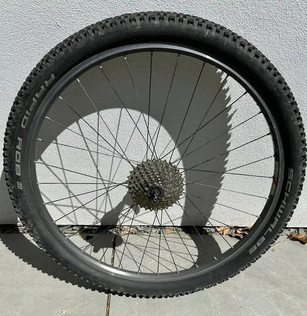

I'm not sure if the cassette is going to be useable again, although it doesn't seem to have suffered much to the naked eye. A new lockring is of course required, but those are easy to get. And the new wheel is now in place and working well on the bike!
