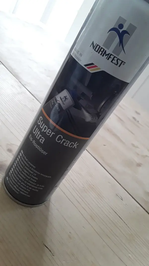

I dont know if any of you are aware of this stuff?
We used it to remove seized manifold bolts etc at work. Its a ultra freezing spray with penetrating oil.
Just dont get it near your hands eyes etc as it comes out! Its errrr......very cold.......very very cold.
Its the best we found, i think we tried everything at one time of another.

Not heard of that stuff before, thank you!
