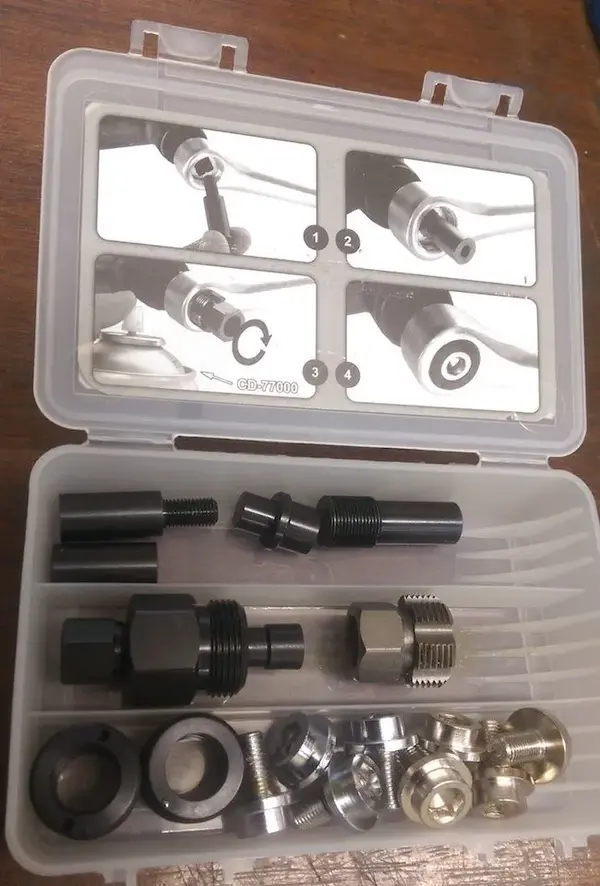

Stripped the thread on my crank trying to get it off....
Once you get it off try the screw the puller through from the back side trick, sometimes if it's just the first few turns of thread that's enough to repair it.
